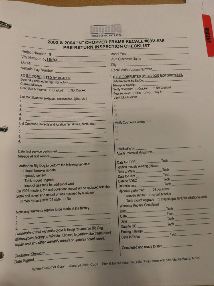

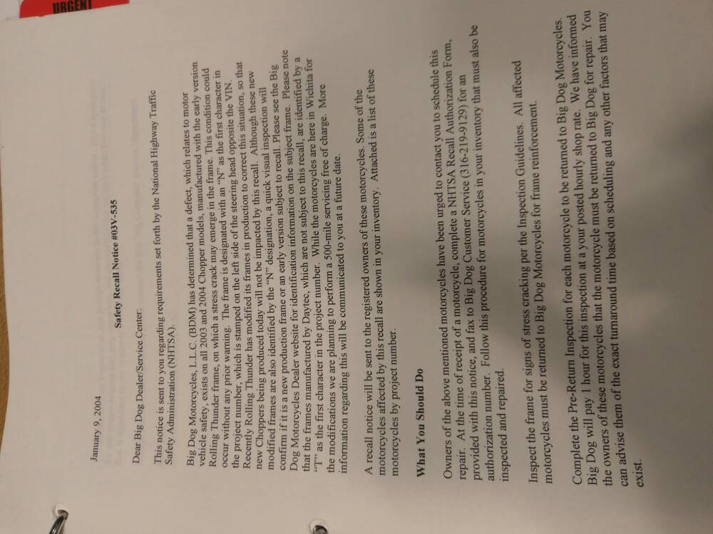

    Haha well here's your frame bulletin.
    Also, if it happens I've attached the form to fill out...you can then hang it on your refrigerator. Lol

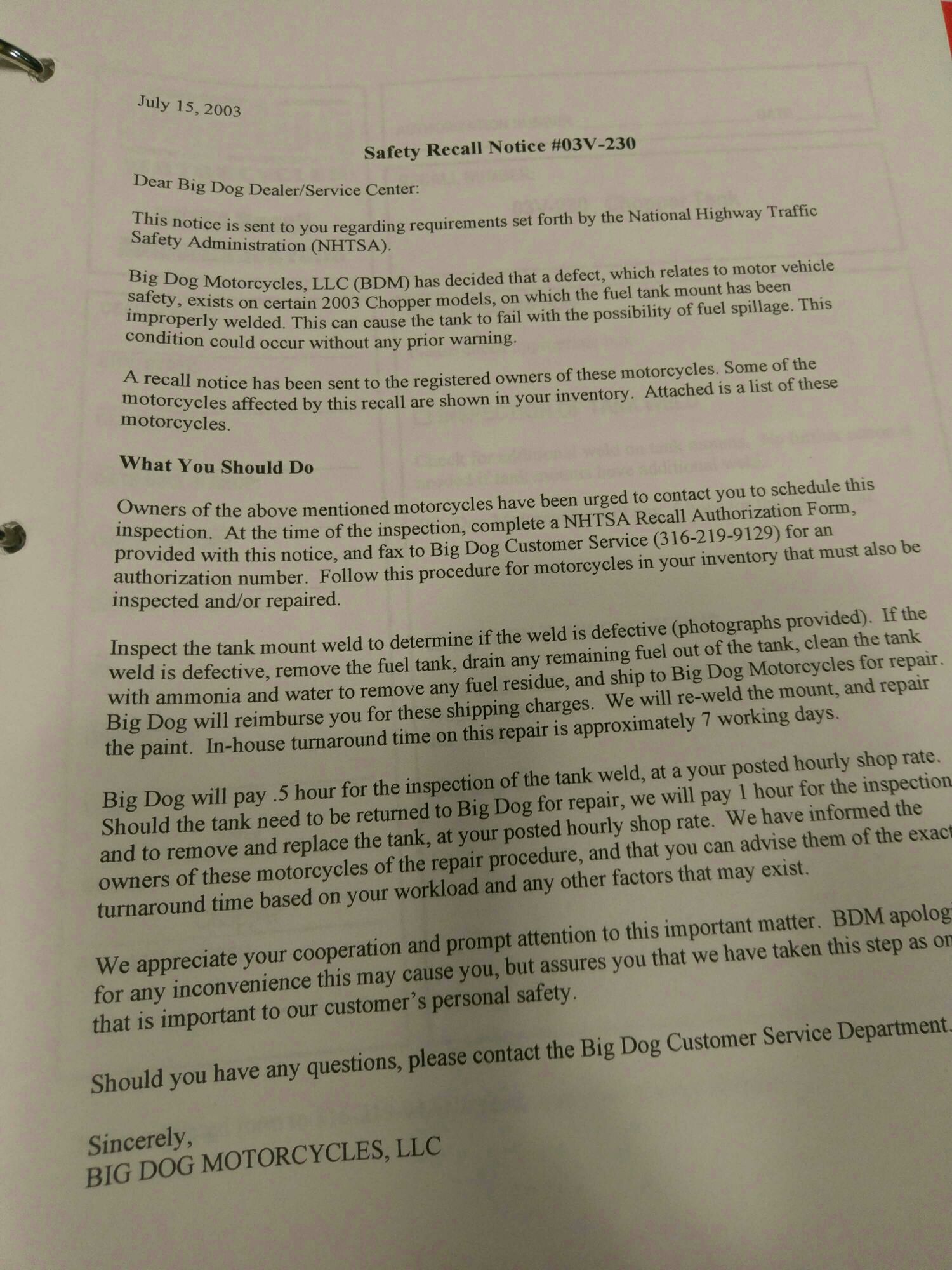

    Oh and don't forget about the fuel tank mount defect.

    Trying to figure if I am lucky or not. Seems like my struts are not about to break, but frame is.

    Struts there was a recall in 03 too lol

    Yep, for the other frame! remember, DT and RT big difference! DT frame holds, but rest falls apart, RT frame falls apart but rest is OK! Except electronics, starter, speedo and some other minor parts

    7/15/2003 03V-230
    Big Dog Motorcycles, LLC (BDM) has decided that a defect, which relates to motor vehicle
    safety, exists on certain 2003 Chopper models, on which the fuel tank mount has been
    improperly welded. This can cause the tank to fail with the possibility of fuel spillage. This
    condition could occur without any prior warning.

    1/09/2004 03V-535
    Big Dog Motorcycles, L.L.C. (BDM) has determined that a defect, which relates to motor
    vehicle safety, exists on all 2003 and 2004 Chopper models, manufactured with the early version Rolling Thunder frame, on which a stress crack may emerge in the frame. This condition could occur without any prior warning. The frame is designated with an “N” as the first character in the project number, which is stamped on the left side of the steering head opposite the VIN.
    Recently Rolling Thunder has modified its frames in production to correct this situation, so that
    new Choppers being produced today will not be impacted by this recall. Although these new
    modified frames are also identified by the “N” designation, a quick visual inspection will
    confirm if it is a new production frame or an early version subject to recall. Please see the Big
    Dog Motorcycles Dealer website for identification information on the subject frame. Please note that the frames manufactured by Daytec, which are not subject to this recall, are identified by a “T” as the first character in the project number.
