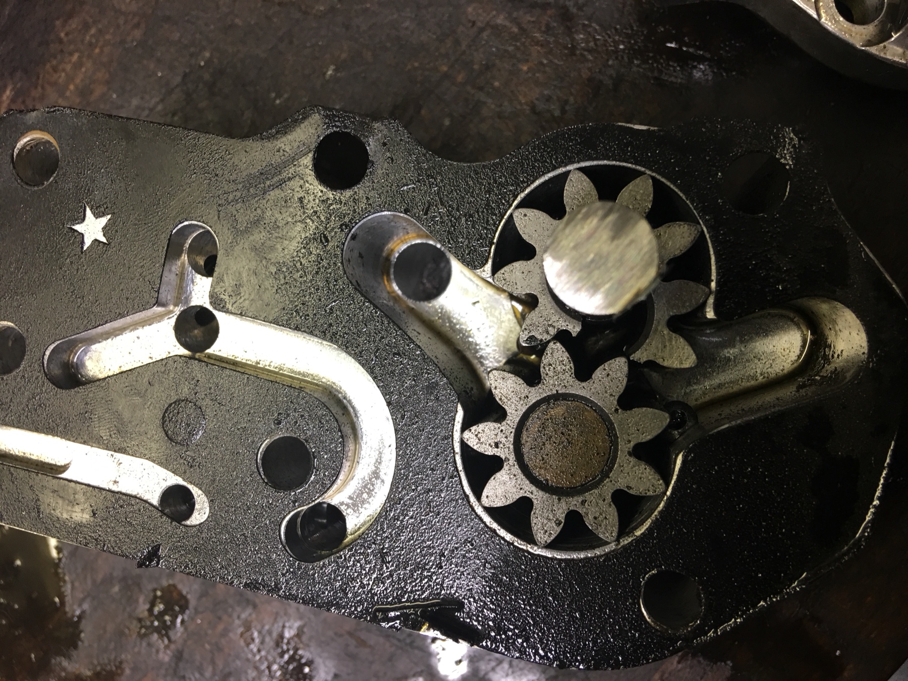

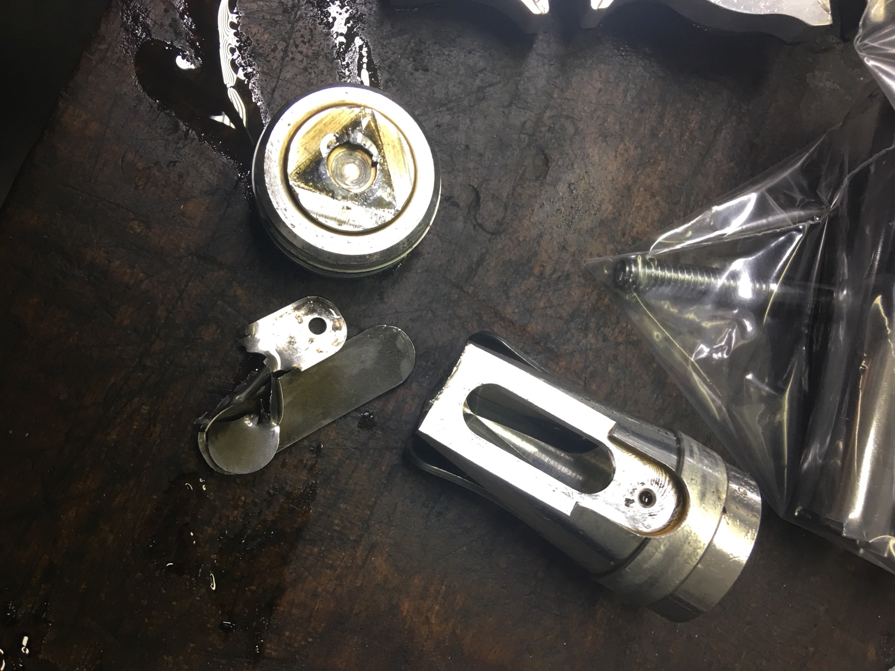

    So, I’m back home and the cause is coming clear.... reed valve for breather was broken ! piece of it (most likely) found its way to oil pump and caused a ”little” problem....
    [​IMG][​IMG]
    What in earth broke the valve is a mystery, or maybe the whole sequence was other way around ...

    Your oil shaft looks broken too? Or did you cut it?
    How's the rest of your crank case?
    I replaced my oil pump because that damn shaft snapped as the woodruff key got stuck and welded itself into the gear. I replaced it with an ultima it's half the price as the S&S and hell I actually get better oil pressure numbers with the ultima High Flow pump than the stock S&S. It looks a little different but hell you can't see it! And now that your this deep in the oil pump you'll come to the same conclusion it's just a piece of aluminum can't be anything different between ultima and s&s then the price.

    The shaft needed to be cut... not sure if I go Ultima or S&S , maybe S&S

    Bike is in pieces, new pump ordered... never figured what broke the reed valve....
