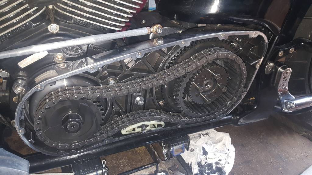

    I pulled of the primary cover and found a broken bolt i cant find where it came from . I pulled out all the clutch plates . But i noticed where i just pulled them out theirs a lot play [​IMG]

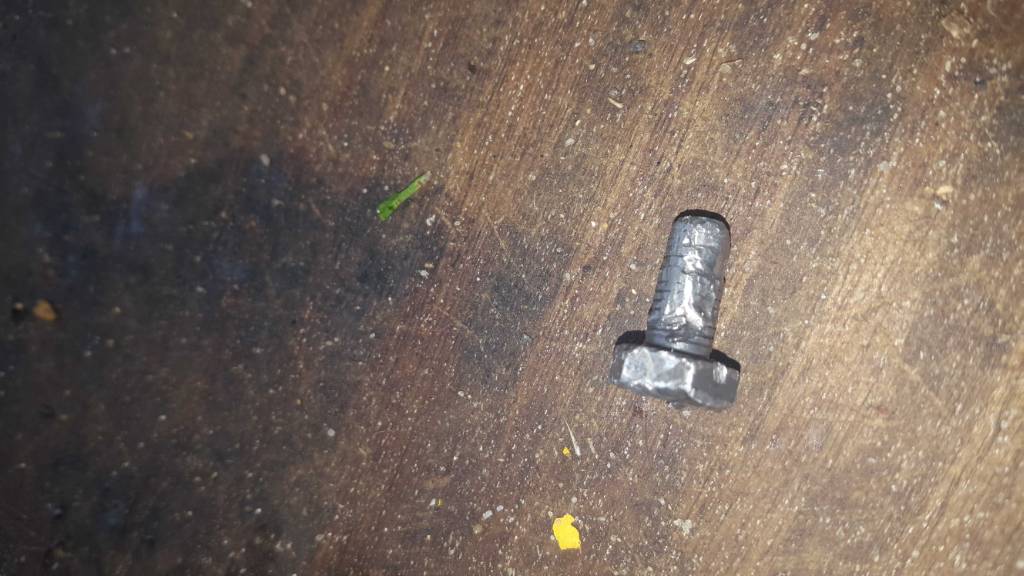

    Chain looks loose, might want to check that too. Post a pic of the broken bolt like Paul said, someone may be able to tell you where it came from.

    This is it[​IMG]

  13. Th3InfamousI

    Chain is loose... And it looks very loose...lol

    That looms like a bolt that holds the inner primary on.....wondering if a lock tab wasn't put back

    Would that be a bolt for the guide or tensioner?

    The play may be a loose hub nut...

    I think you are right Eric, I can't see the lower bolt but you can see the upper one does have the locking tab on it though, shit I thought my chain was loose when I saw it, but this is "Really" loose!
