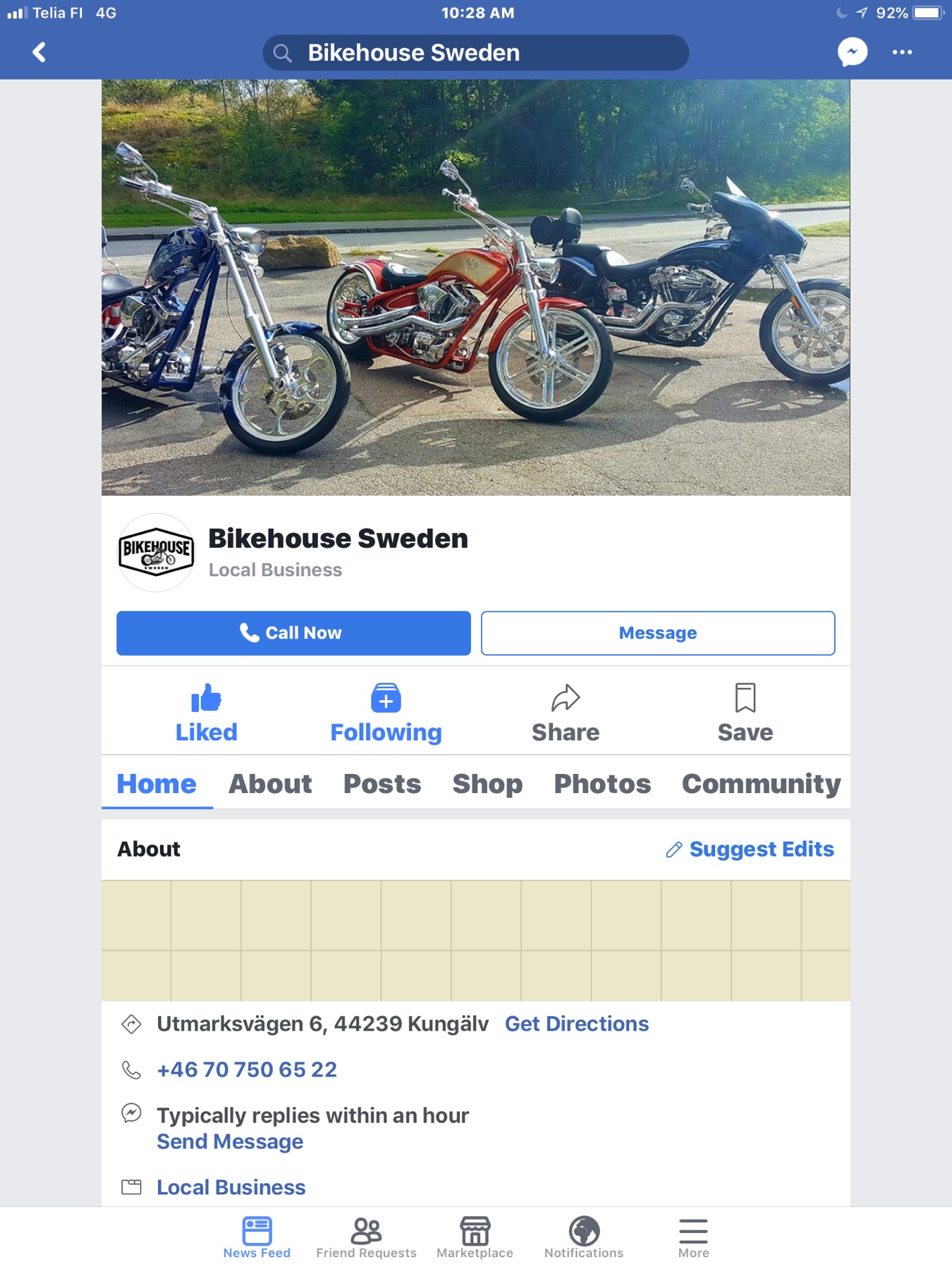

As far as I know a few Swedes have done it, I think best guy to contact might be Dragan Tanaskovic, Bikehouse Sweden.
Curtis mentioned he got the mods to the primary covers done.
