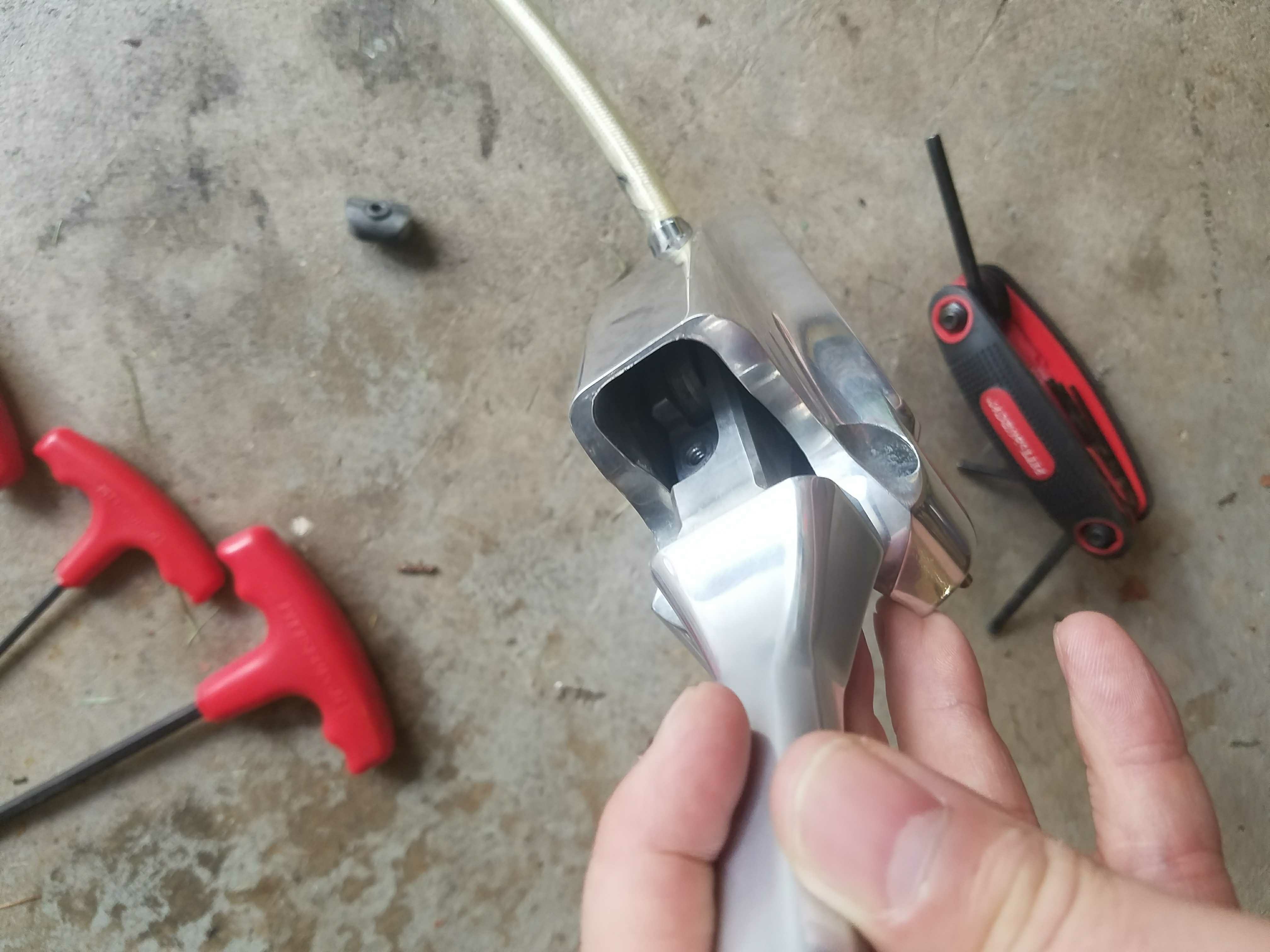

    I pulled the push rod and ball ramp assy off... when I move the cable I can see the push rod move a little. I'm trying to find a parts breakdown for the clutch lever housing but I can't seem to find anything the the service manual. I think I may have lost something out of the lever assembly but if I don't know what's supposed to be there I can't tell what's missing. I don't want to rip into my ball & ramp assy yet until I know I didn't lose something easier to fix in the lever area.

    I have this.... that's the push rod and ball ramp assy.... I need the other end of the cable
    Sent from my SM-G935V using Tapatalk

    This is the diagram I'm looking for[​IMG][​IMG]

    So... it seems I'm not missing anything on the lever side.... does anyone know much about the clutch/transmission? Should I be able to move thru the gears without it going into a gear if that makes sense.... it seems as tho my clutch it stuck open with the push rod completely removed.
