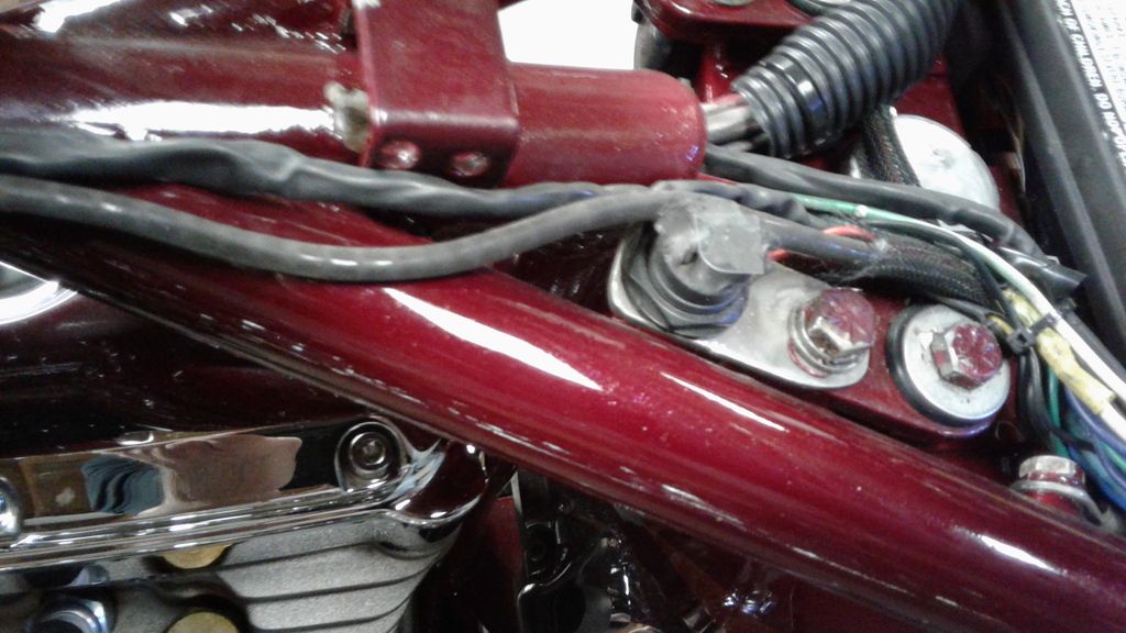

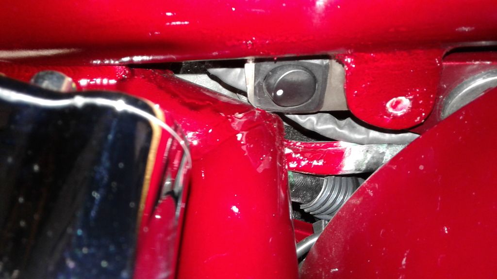

    I'm running a toggle switch on mine. The key switch is just there for looks.
    Matheny 514, chubs and BigDogRick like this.

    How'd you set that up? Hidden?
    chubs likes this.

    You can put it anywhere. If it has a key switch, no one will think about it having a toggle switch to turn it on. If you turn my key switch on, it blows the horn. Which is one of those Bad Boy air horns.

    Nice. What do you wire it to? Would you want to wire it to the wires that go to the key switch at the switch, or would you want to just splice in near the EHC?

    Use the switch wires, so you don't have to mess with your wiring harness. Mine is hard wired, and all my switches are ground switches, meaning the just ground a relay.
