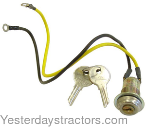

    Any thoughts on a problem I'm currently having. When I turn on the ignition switch nothing happens. later when I try it everything works fine. I'm wondering if it's the switch. I'm no good at electrical problems need all the help I can get.

    Yeah.. definitely the switch.. I dont what set up u have but it seems to me everyone is using the factory supply switches for replacements.

    Are you saying the bike is completely dead, no lights or anything?
    If that's the case, unplug the switch and use a small paper clip to jump the connector to see if its the switch before replacing it.
    Tractor Supply switch for a 8N or 9N tractor

    I found the tread on the switch from tractor supply I will jumper the switch. The speedo will not turn on and sweep. Then it will work fine.

    I have replaced my switch at least five times in 17 years. It is a simple on-off switch that can be replaced by any type. Once, I replaced it on the road back from Sturgis with a trucker's dash toggle that lit up and everything. Up-on. Down - off. The thing to be aware of is that the housing that holds the switch is shallow and only has room for a very short key. A key cylinder with only a couple tumblers is subject to the key wearing on the tumblers and the key falling out from vibration while you are on the road. I used a dremmel and hollowed out the back of the billet to make room for a more substantial switch that requires a longer key. Even so, they wear out with time.

    The switch from Tractor supply was a direct fit with nothing to modify to install except the wire splicing and its been in for 2 years and it has never fallen out. But DOC does have the OEM:old2:
