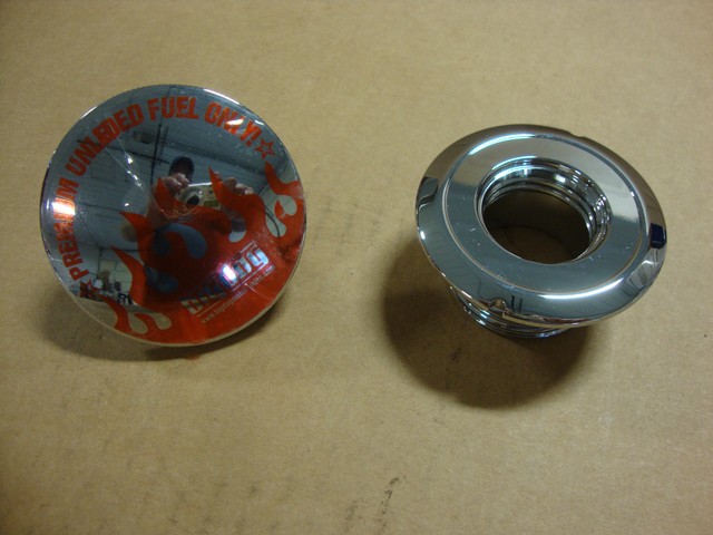

    Pm me your info I have 2 brand new ones I'll send ya one cap and paint saver same as shown in pic provided in previous post you will not need to remove the paint saver but I'll send it with the cap

    Paint saver can be a nightmare to remove huh? Mess paint up
