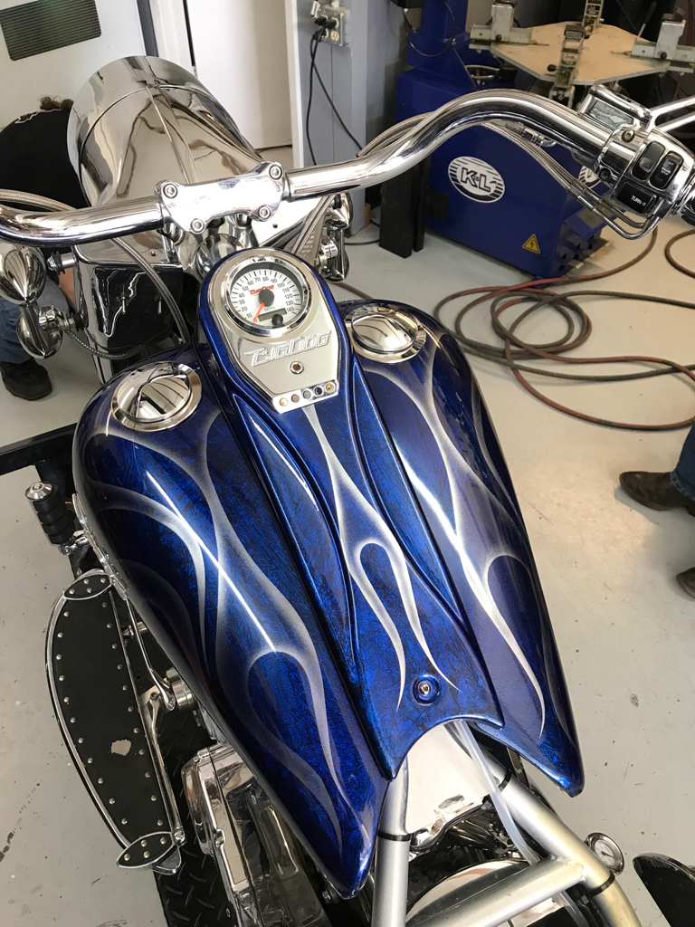

    After a bit of a mothball of the rewire project I reached out to Shannon (Mr. Wright) and we flew him in to Phoenix and got ‘er done.[​IMG][​IMG]

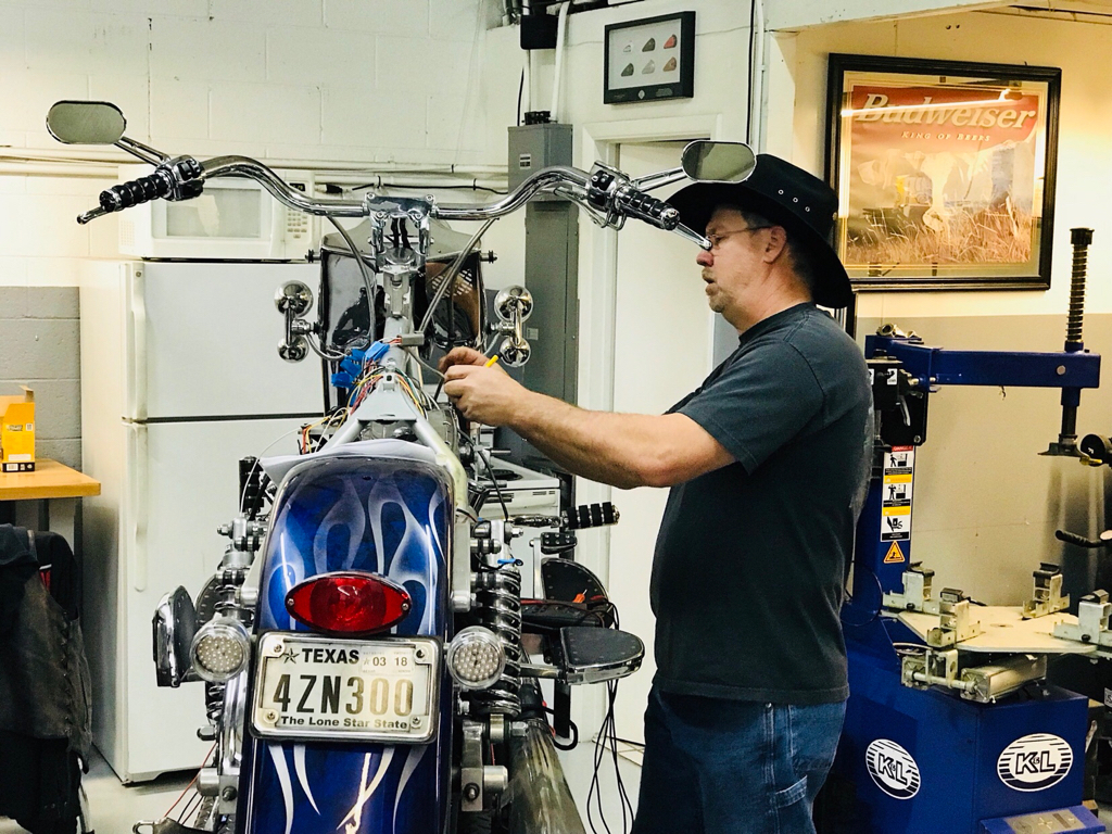

    First goal was to get everything matched up and wires connected without solder and shrink wrap to confirm correct connection.[​IMG]
