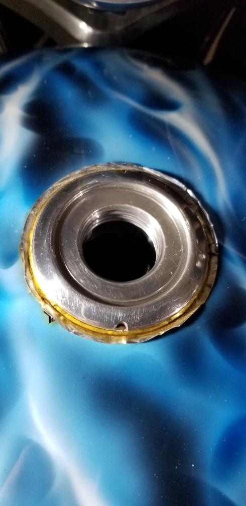

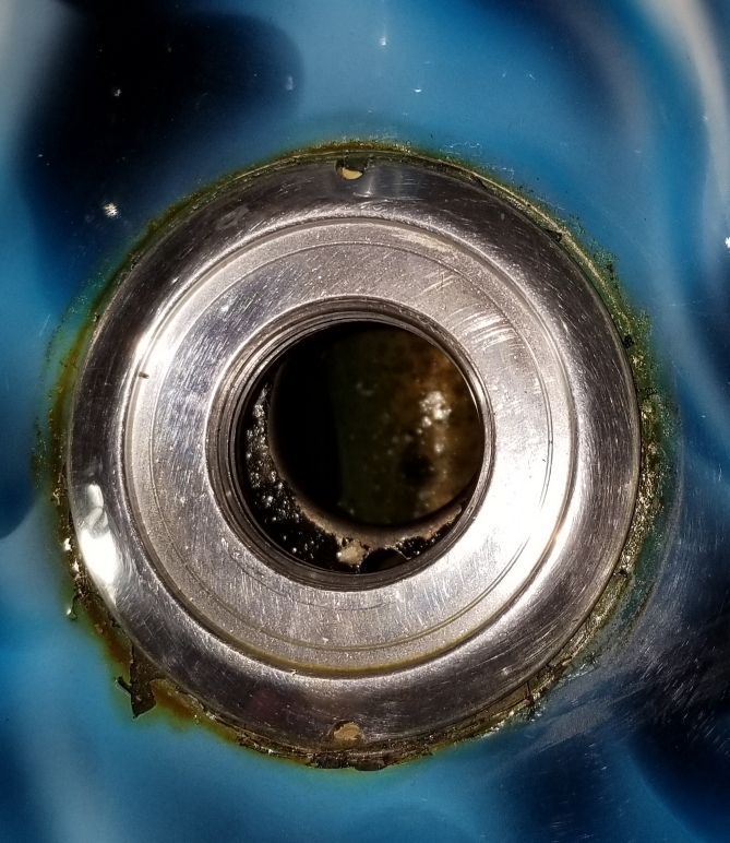

    Forgot to update. I finally was successful! After a 2nd removal tool, spraying WD-40 under paint saver, slight heating with heat gun and crescent wrench. Didn't even need much torque! Thanks again guys. Of course now I have the issue of removing the remaining parts of the
    rubber gasket that is hard as a rock! Tried shaving off with blade, some came off but worried about having an accident and further damaging my paint around opening.
