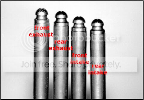

I think I found another reason why I may have low compression. After total frustration had set in, I decided to go back into the motor and see what I missed the first time. After removing the rocker box and pulling the push rods, I noticed that my longest pushrod was in the intake! I know that it goes to the exhaust but I obivously swapped them up when putting the motor back together again. Now, I'm half way into this damn heathen again. Can any of you guys confirm that swapping the pushrods would indeed cause lower compression in that cylinder? I'm going to get some lunch and have a beer and hope that when I get back, Dennis, Dead, V, Marv, Ray, Tim, Lee or some of you other "mechanics" can confirm my questions. No need to get it put back together at this point. I'm ready to get back in the saddle. But not before I get this resolved. I was heading towards pulling the head, changing valves, springs, rings and lifters. I guess even after doing all that, if I swap the pushrods, I won't be any better off. I guess my real question is, can you swap the pushrods and still adjust them to the proper lengths?

Brad, I wouldn't think that having the pushrods in the wrong position would cause any harm. The difference in length is minute and the adjustment would take up the difference if you ask me.

Ray, That's what I was thinking. After thinking about how stupid it was to get them in the wrong positions, I got to thinking that unless the ID was different, then the adjustments should compensate for ignorace. :spank: The push rods appear to be straight.
Having the pushrods in the wrong place is definitely not doing you any good. Yeah, I know, "Thank you Capt. Obvious!".
But if you consider the adjusting threads on a pushrod (I believe) are 5/16 X 32. This means that three FULL turns only gives you .093". Looking at this photo from the S&S manual...
There's substantial difference in overall length so if you take into account the tolerances we're talking about it looks to me like having them in the wrong place could very easily explain your lack of compression! If it were me I'd put it back together with the rods in the right place, adjust them, and before I put the rocker covers back on I'd rotate the engine (slowly!) while watching the valves to make sure everything is working properly and neither valve is sticking. I compression check at this point wouldn't be a bad idea either...

...I got to thinking that unless the ID was different, then the adjustments should compensate for ignorace.
Doesn't seem like if that were the case there wouldn't be a difference in length in the first place? :confused:

I know that the pushrods are different lengths due to the distance from each lifter to its perspective rocker arm. How ever I have a set of Crane Timesaver Pushrods and they are all the same length. Only difference is that once adjusted they each have a little more thread showing. If the valves were properly adjusted I don't see where the difference would be other than more thread showing and the rod maybe being weaker due to greater % of thread showing vs the actutal rod strength its self (saying that the hollow tube/ rod is stronger than the threaded adjuster). If the rocker to be adjusted is at it lowest point on the cam you still adjust it to zero lash then the number of turns you want for your adjustment 3, 4, etc. Or somthin like that:confused:

The difference in pushrod lenghts is all about reliability. As mentioned, having to few threads in the pushrod tube could eventually bite you. You need to change them back.
