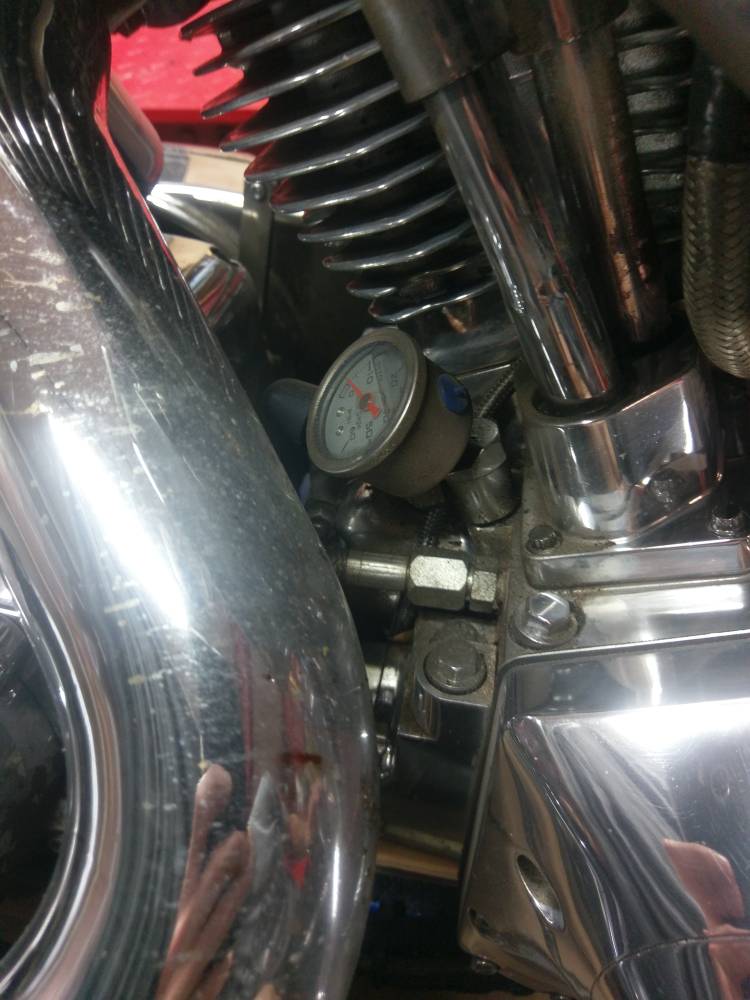

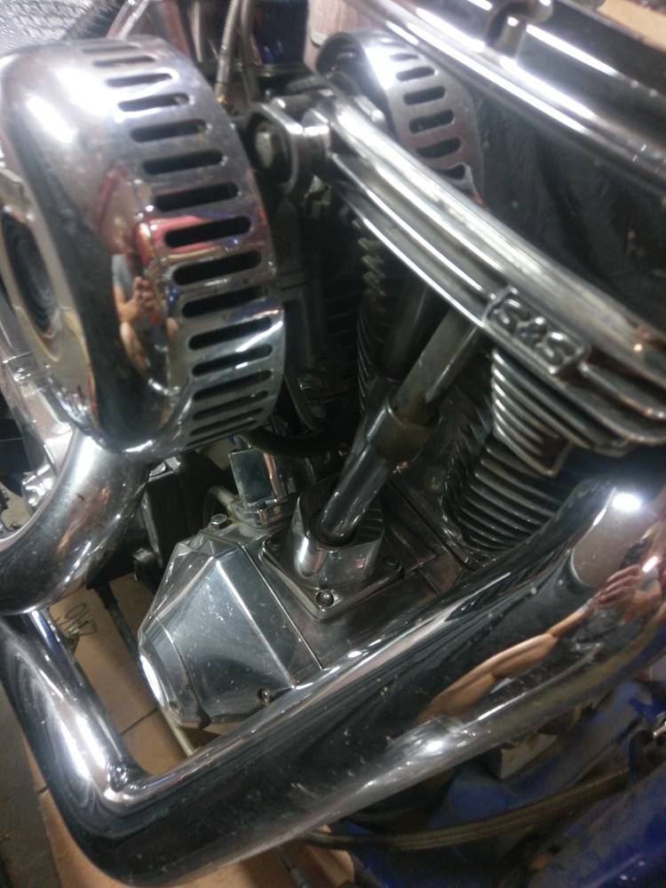

    I use a paint stir stick with a microfibre wrapped around it to apply the billet polish, then cotton rag to wipe off, as told to do by dentdude.. I have tried a few attachments with my Dremmel but the felt gets wrapped up in the diamond cut. The fins are trial and error, find something thin but not sharp to wrap your microfibre or rag around, and be patient, it's fuckin tedious...

    I realized dull aluminum on fins is on fashion! I just polish the edges...

    I used to try and polish the fins...I got a set of Pimp Stix to do that, it's a pain in the ass. I instead now just polish the top fins you can see (by spark plugs etc.) and then just do the edges of the fins the rest of the way down. Looks great as you can't really see the inner flat parts of the fins anyway with the shadow. I do run a micro over them with the Pimp Stix about once a year when I wash it really thoroughly.

    I use pimp sticks on both bikes with mothers billet both motors look chrome

    Go over fins with 3000 wet/dry paper then compound last billet polish simple

    Actually that's exactly what S&S is doing now. The engines are no longer polished inside the fins except for the head. They just have the natural finish now inside, with a polished outside.
    Well at least that's how the new 124 are. Seen a couple all the same.
