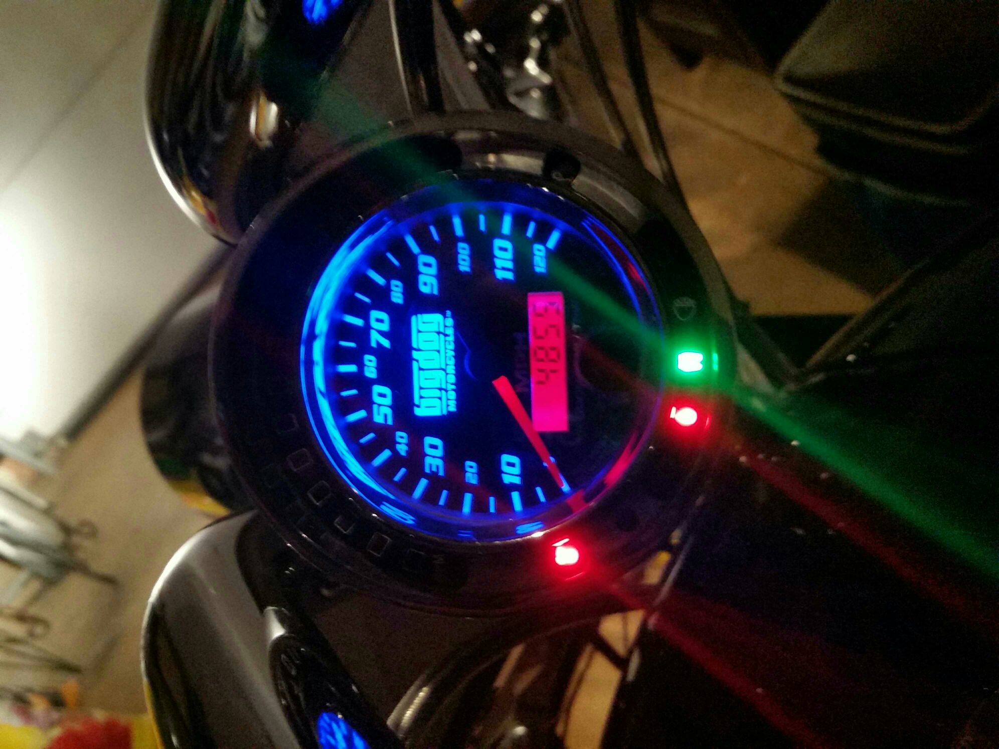

    It is lit up red just wondering what this means.

    My 2010 Bagger has a yellow image of a tiny V-twin engine on the left side of the speedo, but it's a 'check engine' light. I don't think it ever shows red.

    It's the red light on the left Center of the speedo is there is the letter Y not sure if you can see in the picture that stays lit

    Here is a picture with bike turned off. You can clearly see the letter Y middle left side of speedometer. 2007 bulldog does anyone know when y is lit on what that means. Check engine etc.

    First time I have seen it as there is no such light on my vintage but is sure looks like a twin engine to me and I would assume means check engine.

    That is a V-Twin symbol for check engine light.
