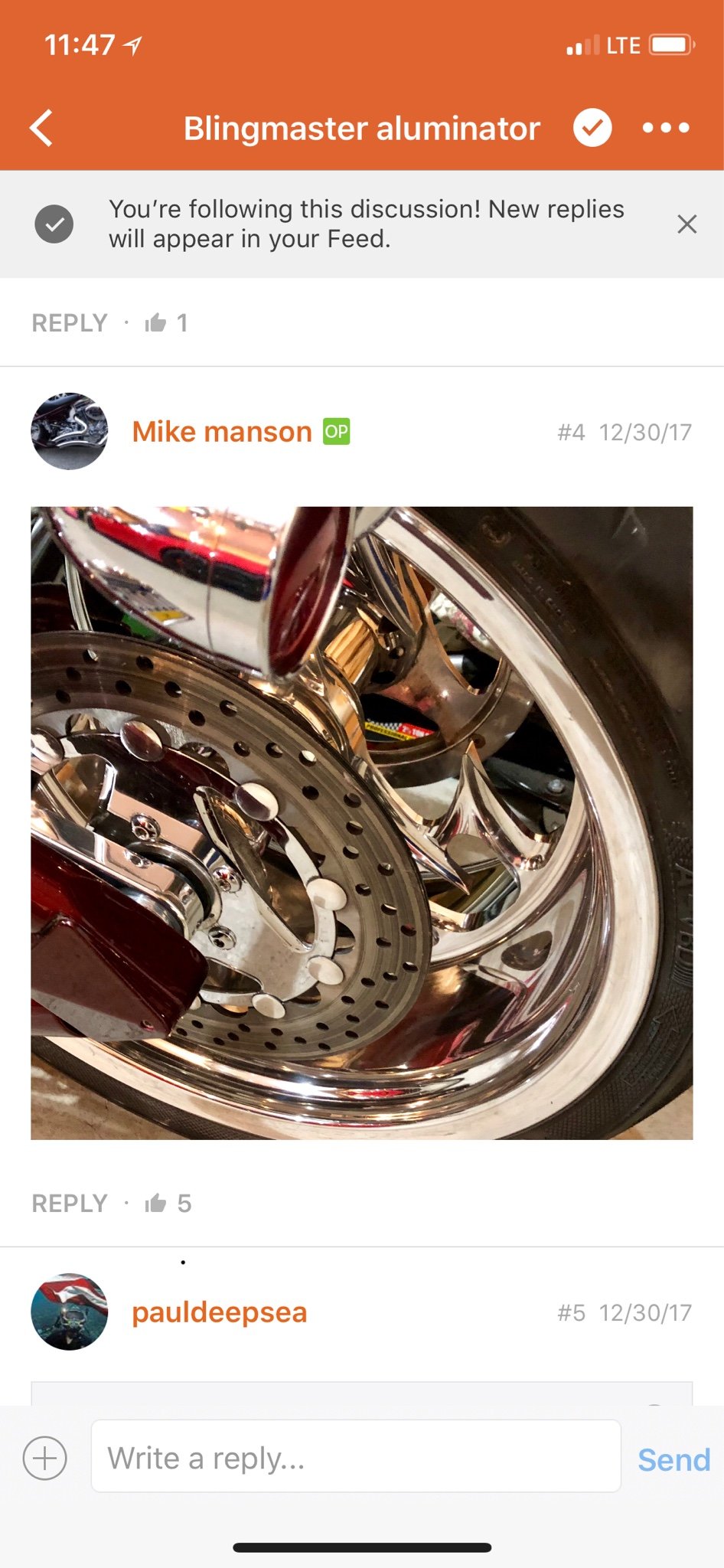

  6. Mike manson
    Mike manson Well-Known Member
    Full Member
    Jul 24, 2017
    1,272
    904
    Erie pa
    2005 bigdog ridgeback
    Mike
    [​IMG]this is a half done pic and half not done jug using blingmaster paint stick and a rag

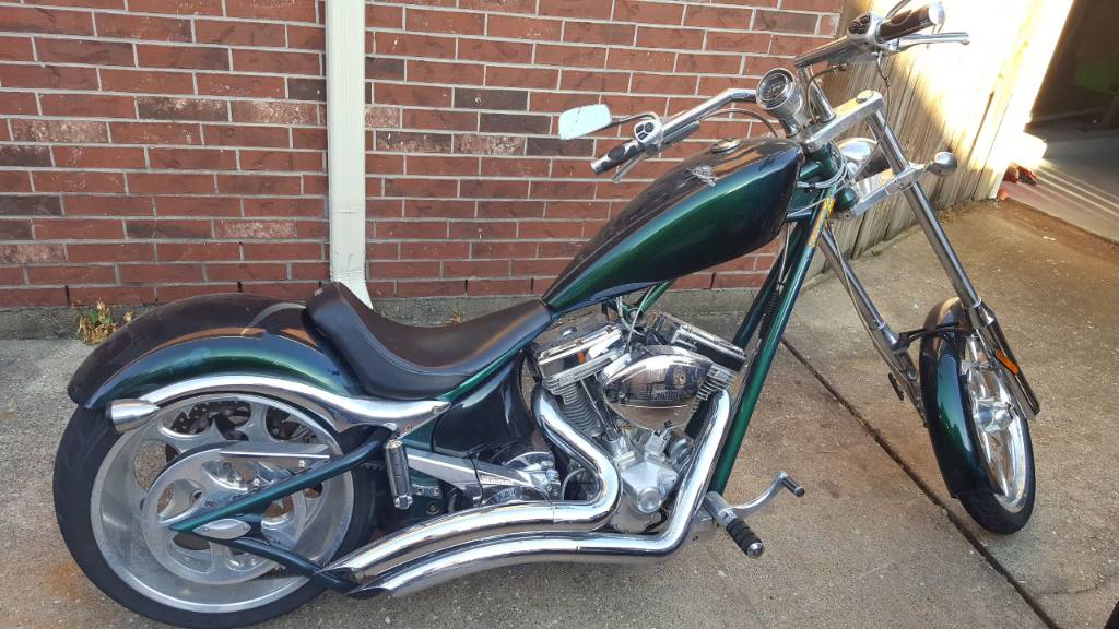

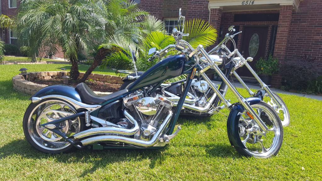

  16. bigkelk9
    bigkelk9 Well-Known Member
    Sep 7, 2015
    3,326
    5,918
    07 big dog k9
    Kel
    I agree.. I had to sand down some rims on a k9 I got for a buddy here locally.. it was horrible.. I started with 1200 and worked up to 3000.. slow and easy and parallel with the rim lip on the dish and parallel with the spokes. They looked chrome when I was done
  17. bigkelk9
    Sep 7, 2015
    3,326
    5,918
    07 big dog k9
    Kel
    Before and after. If u zoom in you can really tell on that rear wheel[​IMG][​IMG]
