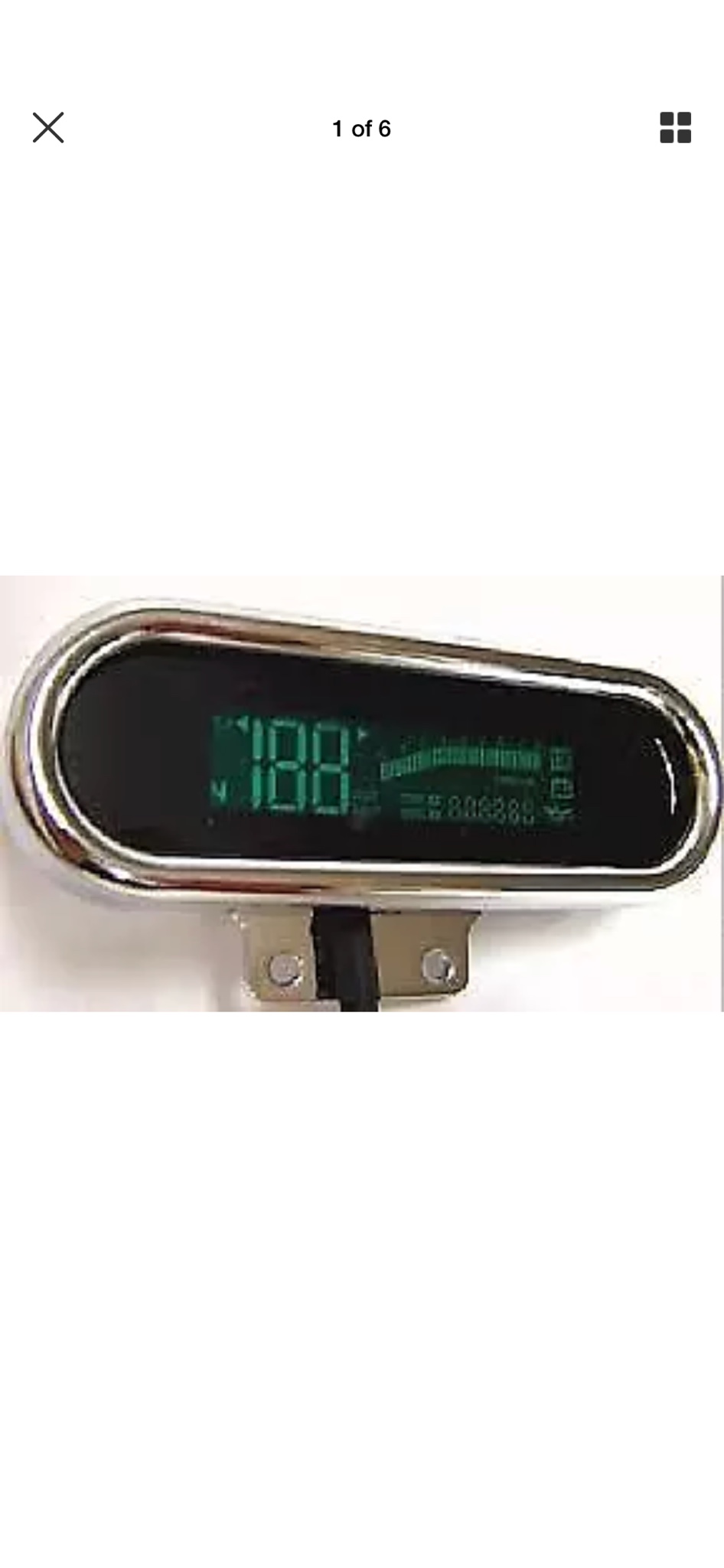

    [​IMG] I can get this one really good price but my bike was wired to harley

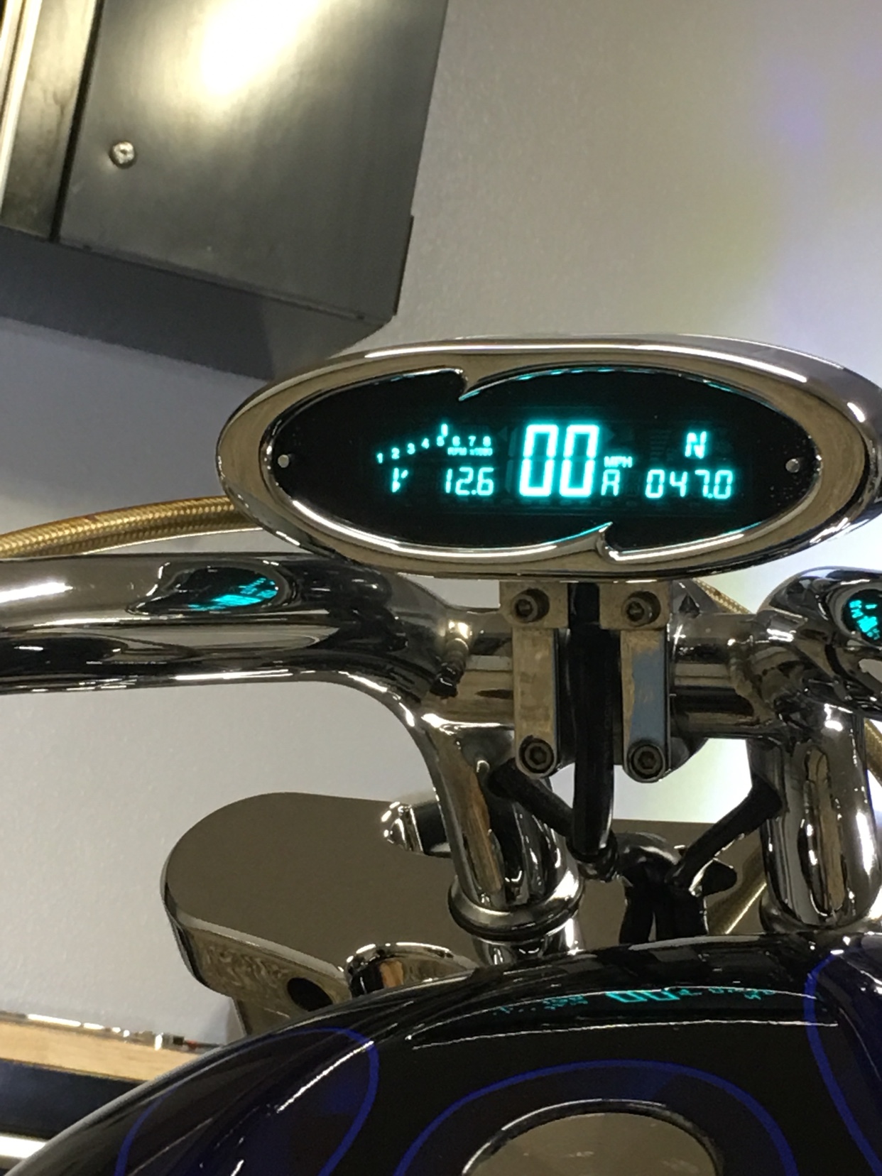

    Those are nice only wish mine could mount under the handlebars without adding risers

    When u order a speedometer do you need anything else but mounting bracket

    I asked the people selling this is there anything else I need to install besides mounting bracket nobody can give a answer

    Are you talking about the Dakota digital that you posted a picture of?
    You should only need the bracket, you will have to splice the wires and solder into the current speedo wiring unless you used a connector to plug the wires together. Pretty easy to do

    It also looks weird mounted on top of the bars

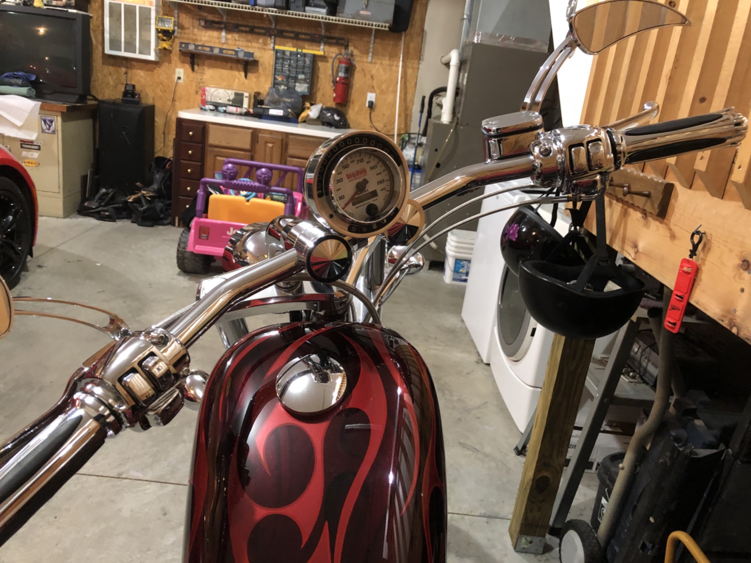

    [​IMG]i want under the bar this is what I got now my bike has been wired to harley so not sure what’s in mine now

    More than likely it’s a solid wiring harness which means no connectors. It should be easy to cut the old speedo out, solder them to the new speedo and use heat shrink over the the connection.
