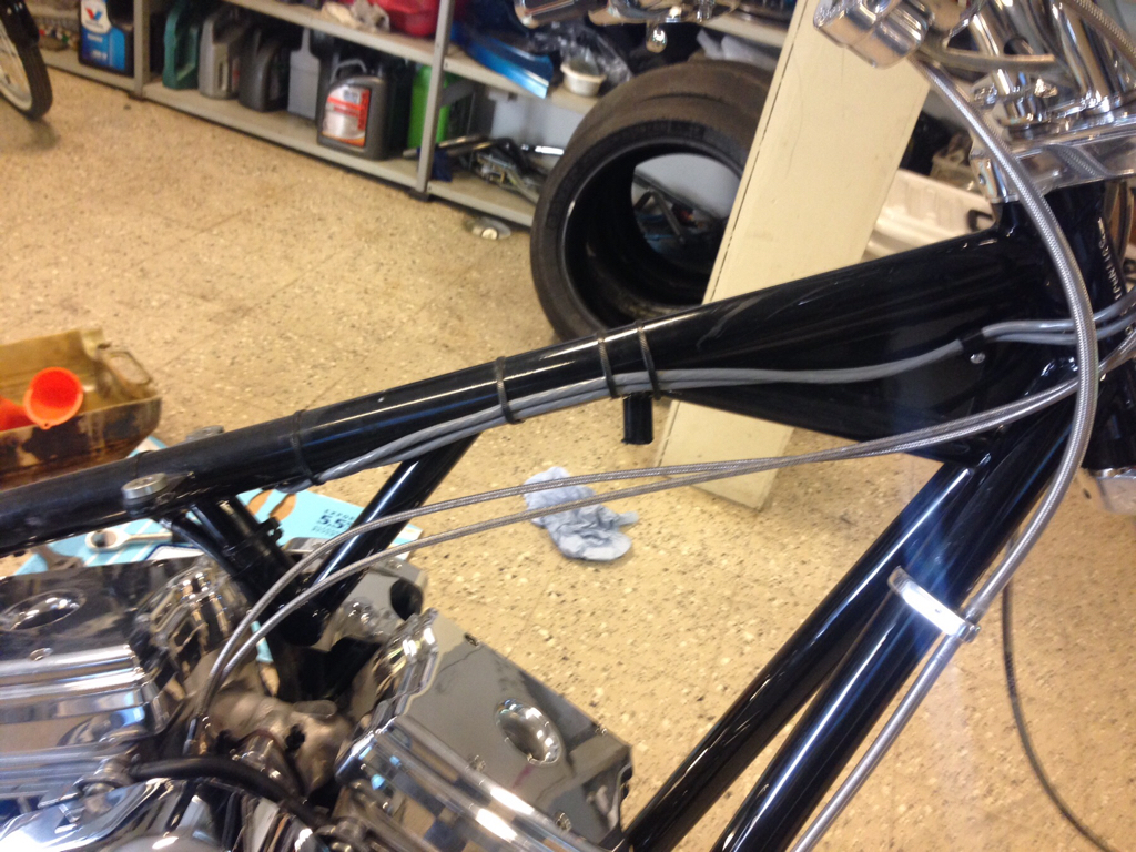

    And you should clean up that damn wiring mess under the tank surprised you haven't had issues there..haha
    Clean and tidy is key! That tank will rub wires bare in no time.

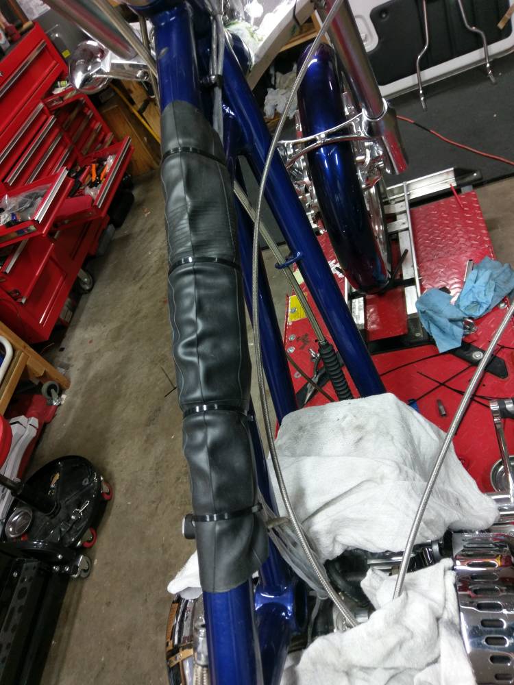

    I do like the inner tube, at the same time it makes me think how the moisture that eventually seeps there dries out and not just stay there and corrode the pins...

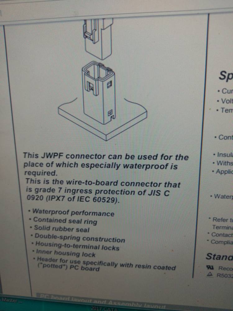

    The bottom of the tube is open so it should still be able to dry out.
    The JST connectors are supposedly waterproof according to the manufacturer so pin corrosion shouldn't be an issue. Grade 7 should be able to be submerged up to 1m of water

    It's all nice and clean when I'm not rewiring some issues.. I knew I should have taken pics of that Velcro sock that u said u knew nothing about.. lol
