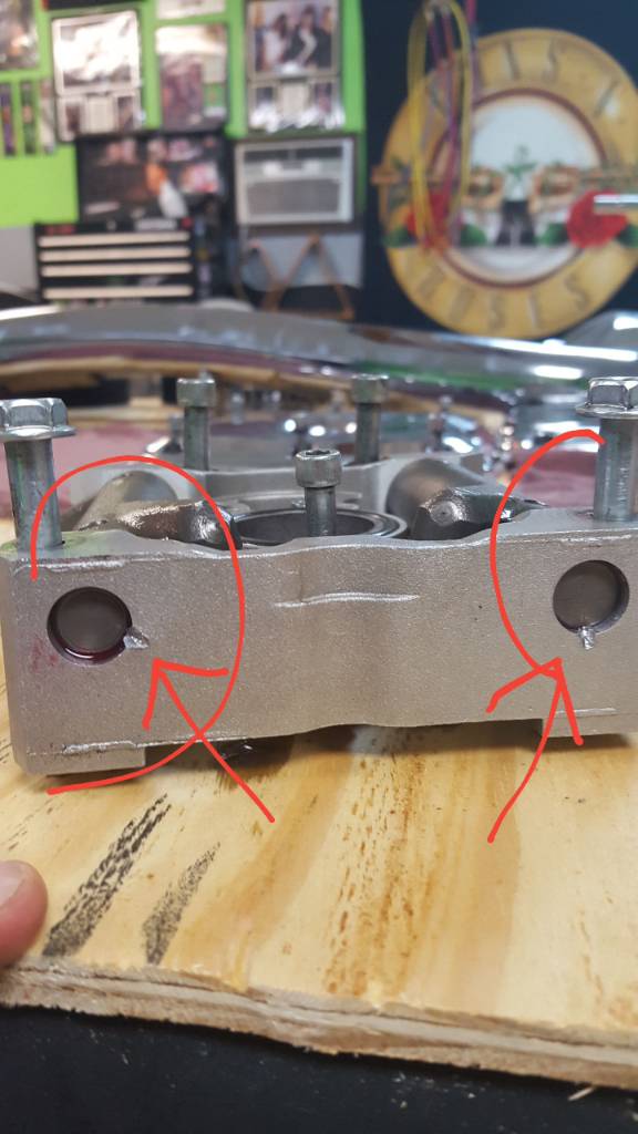

    Here are the options I see to fix this.
    1. Apply a press fit retaining adhesive. (Loctite has a few of these)
    2. Drill and tap a for a set screw.
    3. Cut a slit in one side of the housing so it will clamp down on shaft with bolt.
    4. Find/make a press fit bushing. (Rocker Locker Solution)
    I am amazed after all these years the OEM's have not addressed this deficiency.

    I hear ya, but honestly I feel its just designed this way.
    The shafts are in great shape, super tight the the rockers and the saddles. (Bike has ~20k on it BTW)

    So this is what S&S suggested me to do before replacing bushings and all that.. it's not as loud as it was.. but still noisy.

    07 big dog k9
    Kel
