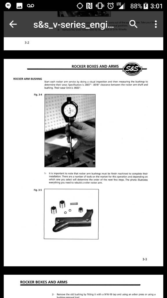

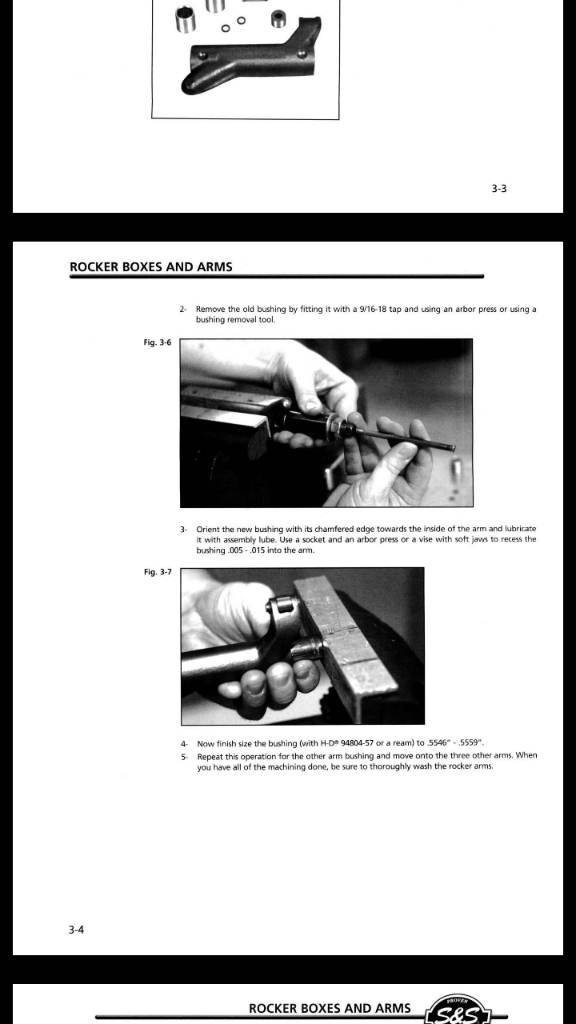

    These are the bushings it's in the rocker ARMS...
    If these bushings are worn them the rocker arm shaft can wear too. Get them both. Bring the rocker arms to your buddies because S&S bushings need to be reamed when installed and the reamer is $200 alone.

    How do you know the shaft bushings are fine? Also that could just mean the shaft is worn.
    Lots of guys with lots of miles...60k plus and no lockers. And I can't find any that fit S&S anyways, then all state Harley. Also the issue was really came to life on the twin Cam Harley's and we don't even have that motor. Maybe John will chime in if he is using them on S&S and where to source.
    Take a look at Marky Marks video on this should help explain a little better with a visual. I know this is a TP engine but same is possible with S&S

    Also note the S&s manual the bushings are in spec between 0.5546" - 0.5559". That's only 13 thousands of an inch!
    That's why I asked how do you know they are in spec? I know I don't trust my calipers to measure that small I got a cheap set.. Haha

    Well good news is shaft and bushings are only about $60 total and if you take it down to your local shop guy have him install the bushings and ream them with the $200 tool your only out about $60 plus whatever be might charge for the bushings gotta be no more than 30 min
