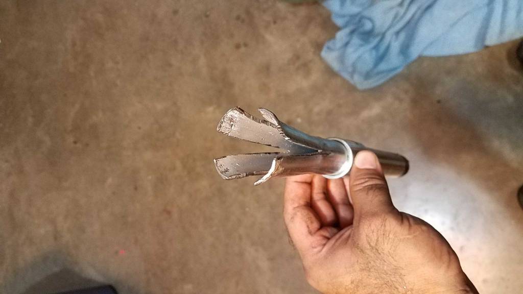

    Couldn't find a readily available extractor...so I made one for less that $6 in electrical conduit, using a hack saw, rotary tool, file, and bench vice. :)
    Sent from my SM-G930P using Tapatalk

    A little adjusting was needed and a tweak here and there, but once I had it right, worked like a champ and had the races out in less than 3 minutes...after almost 2 hours of trial and error tool construction... lol[​IMG][​IMG][​IMG]
