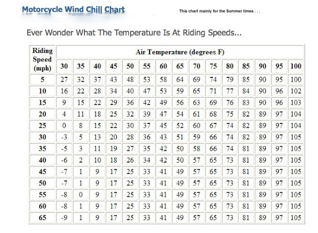

    i don't like when its freezing cold but ill find a decent day here and there to get out and do a few mile loop. and dont forget the wind chill effect.

    -9. Yikes!!!
