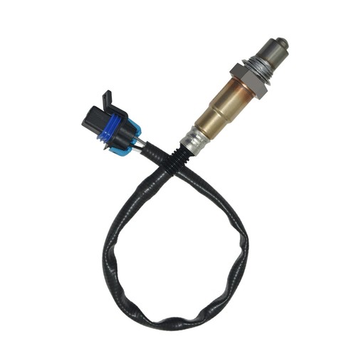

For those who have VFI engines. V124 in my case and have O2 sensor issues.Big Dog is selling them for $395 + shipment ($50).Not sure if they some anniversary edition, they should be for this price. Even the brand is unknown, should be Bosch, but don't look like they are from Bosch. So, I ordered original Bosch sensors. They come in a compressed package with some grease on the thread. The connectors are different though. However, 2 sensors cost me $ 140 with a shipment and I bought to email connectors $ 7 each. Plus, when I was checking the "original" Big Dog connectors, I realized that it is just a pig tail connected to the main harness and one of the wires had about 2 cm of another white wire attached to it. Guys from Big Dog, if you are reading this, my only question is WTF? I think if I get drunk, swallow mushrooms and not sleep for three days my quality of work will be much higher.

Great you found the sensors from Bosch. Might want to post a link of where you found them.
I suspect someone has hacked up your harness. No way they would do that in a OEM harness.
Here is e-bay link:
I contacted bosch directly and they gave me the number of a local (Dubai) dealer.
As for the harness, I can't prove as I bought this bike from one owner, who only rode it a couple of times. I just see how badly the tank was lined inside and the amount of parts I have already changed on this bike, which had only 5,000 miles when I bought it. The bike is nice and beautiful but unreliable, and it is always some electric issue. It is like a BMW or Range Rover, every second day you will be fixing it. I saw one K-9 on the weekend, the owner got tired of all the eternal issues and installed the whole power train from Sportster 1200))). Now he is happy.
