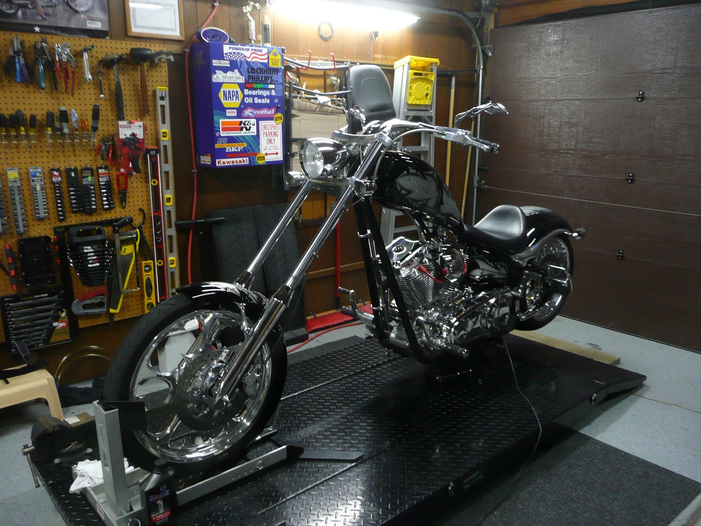

Well as the big and ended up being only player in the second "Gas Man Wrench Day"

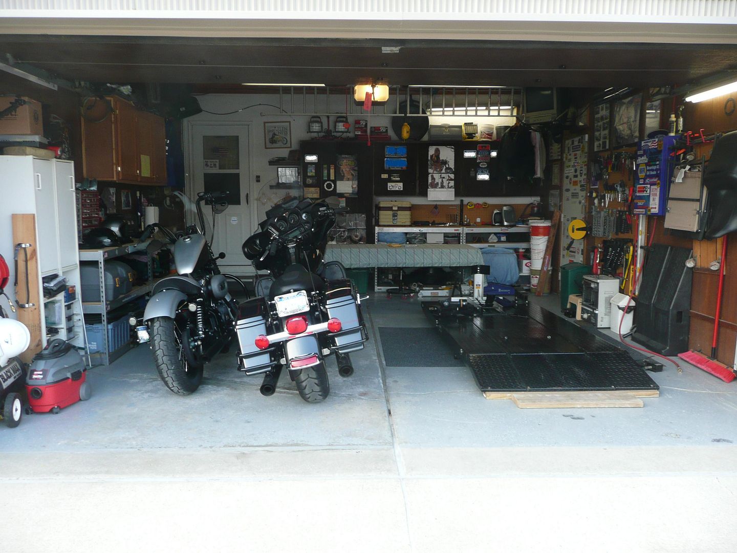

The garage was ready
Dave shows up...
and unloads all his junk
The old EHC...

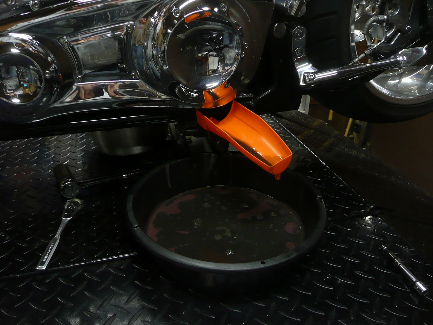

While N8KAM (John) was studying the instructions and setting up for the big job. We changed all Dave's fluids. I just had to take this picture of the HD oil filter drain pan being used... it was out of the box. I thought it was funny

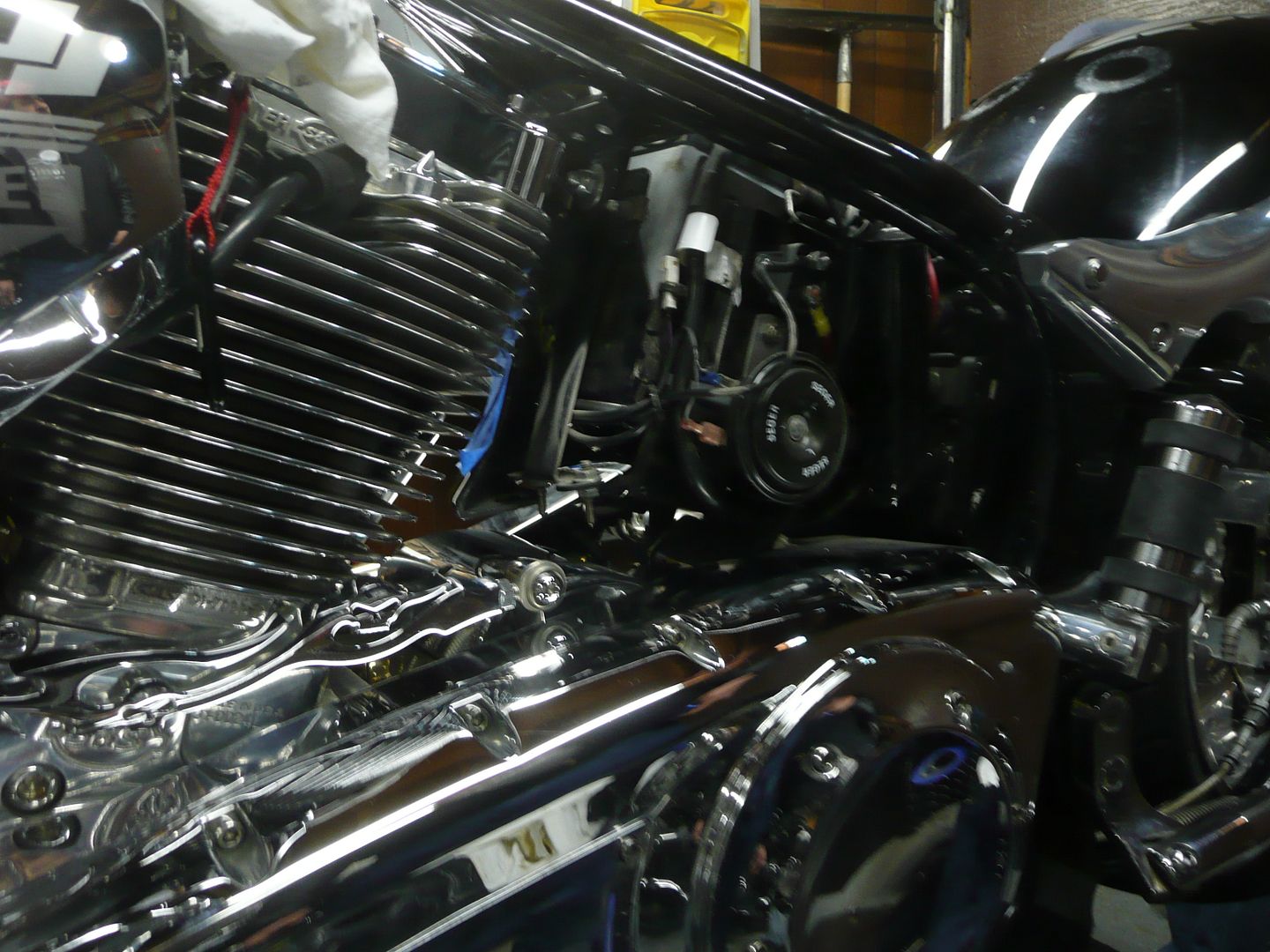

Tear into it...

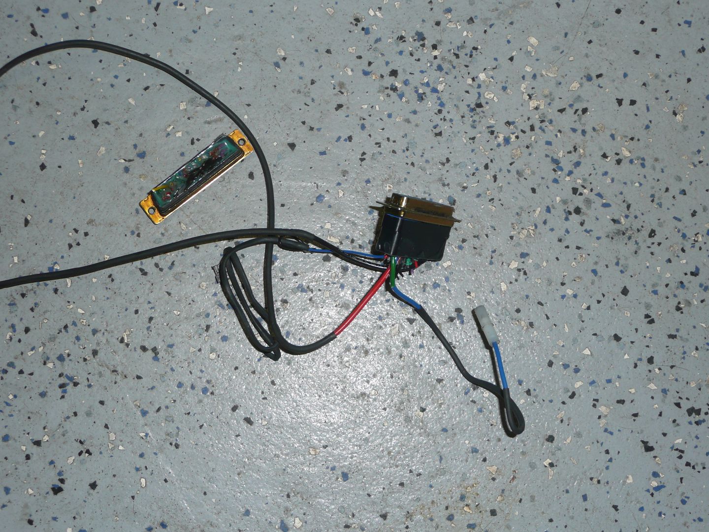

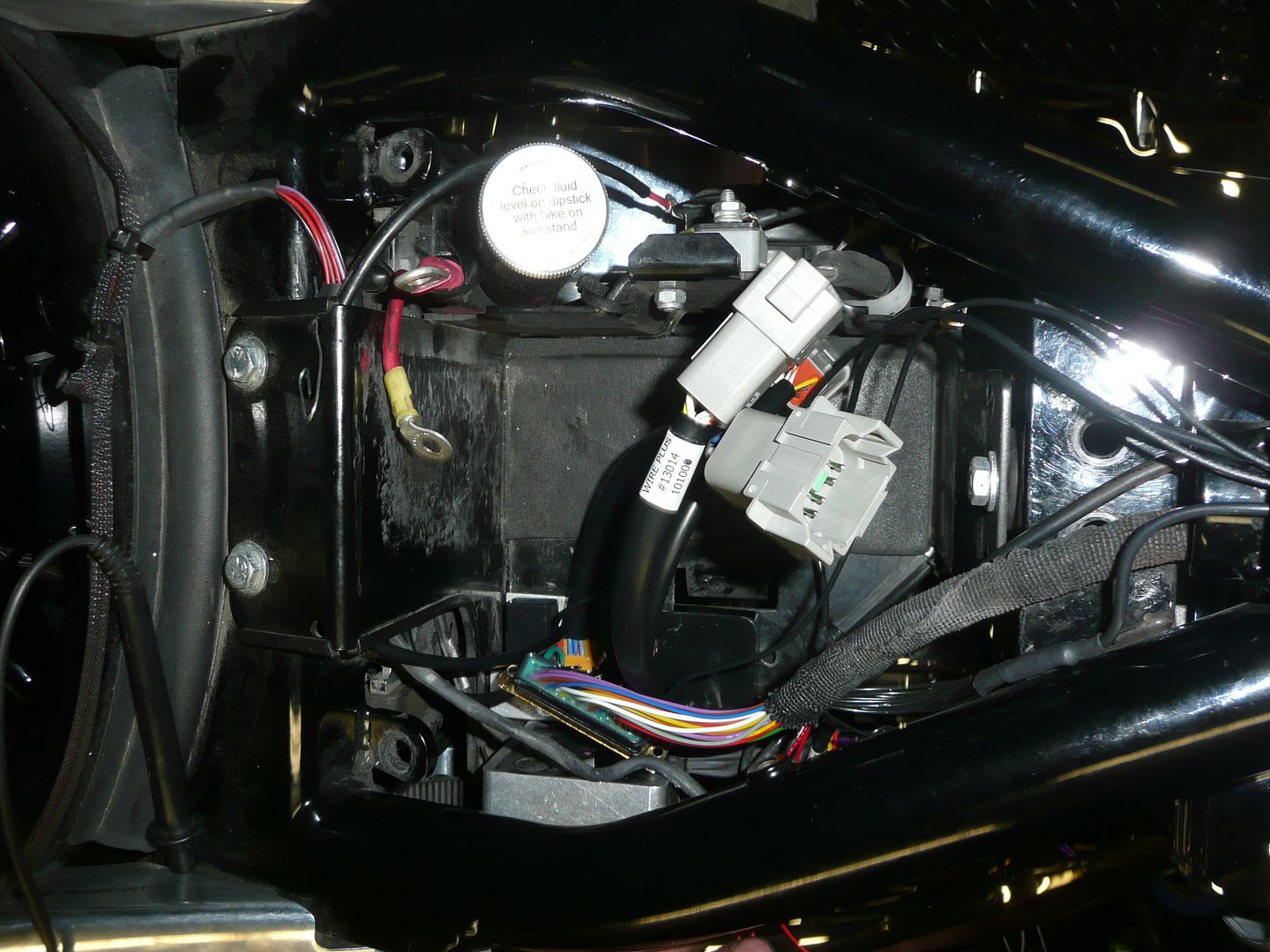

Remove the old

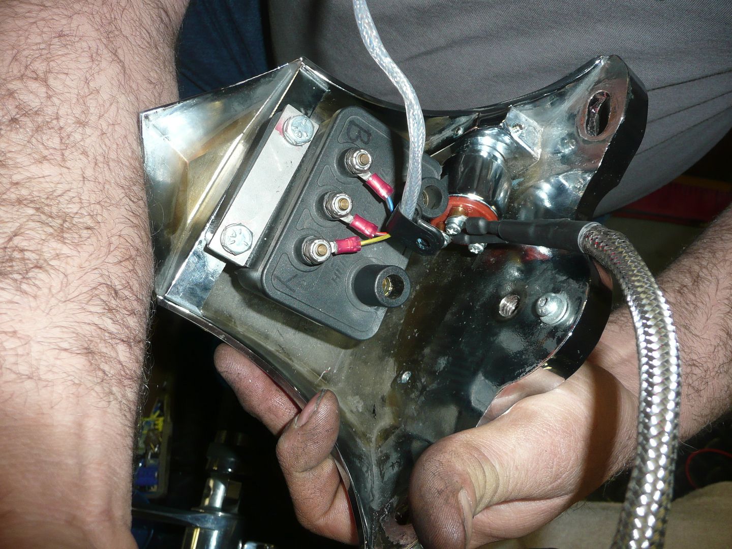

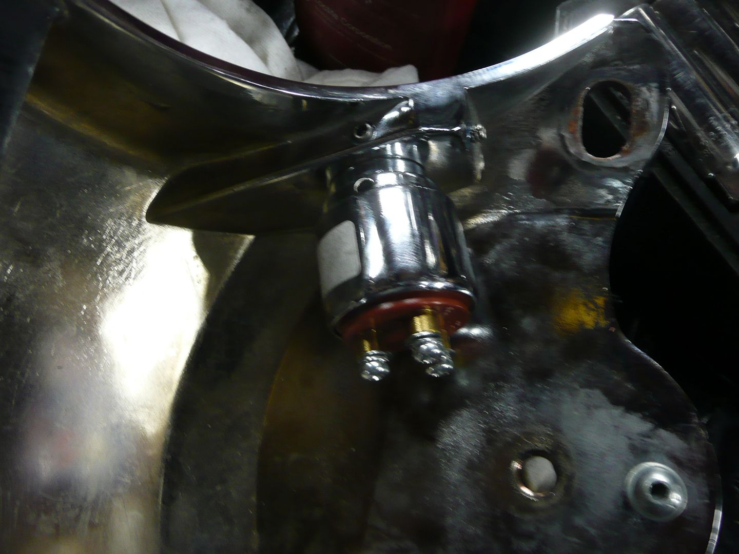

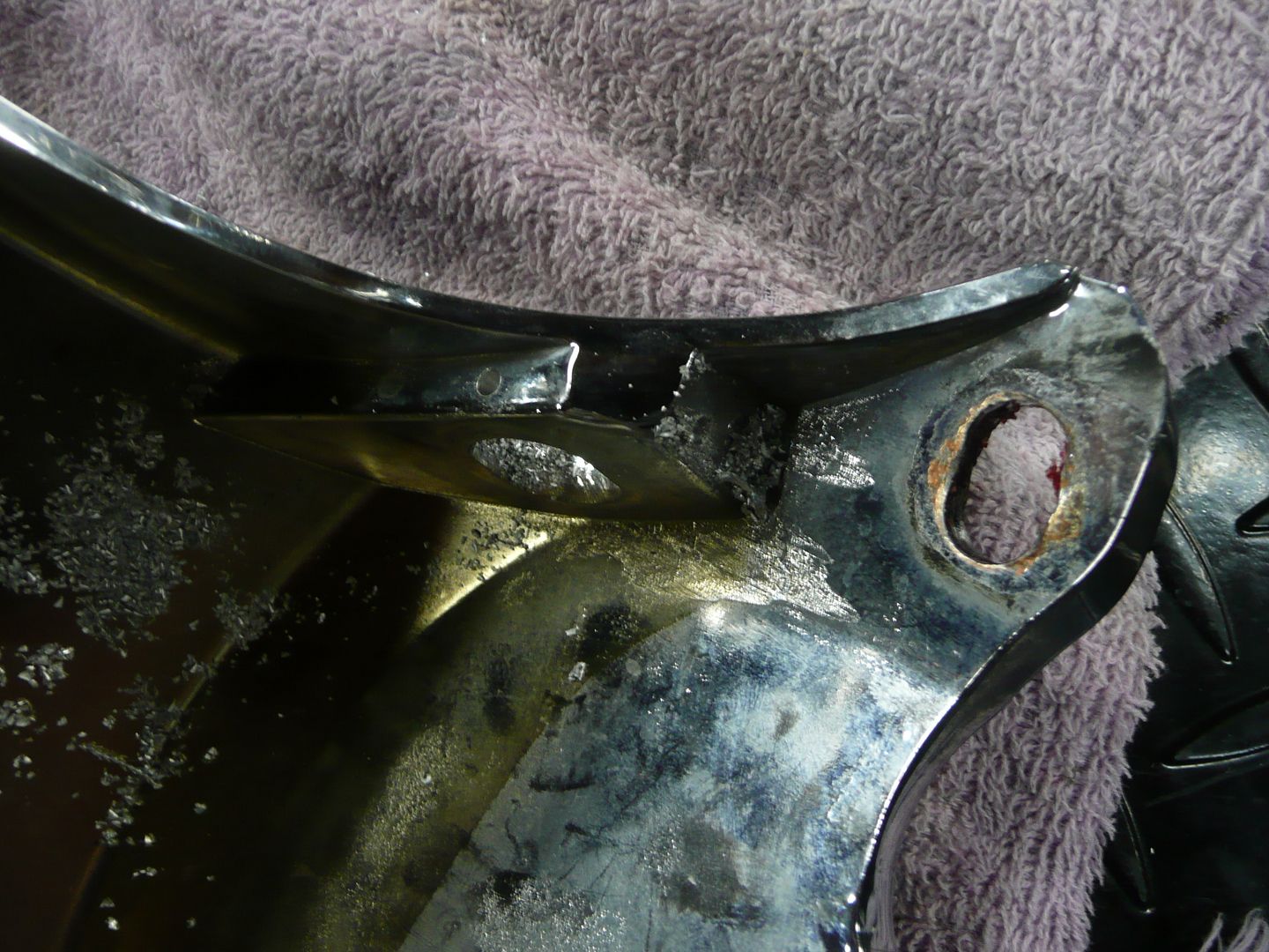

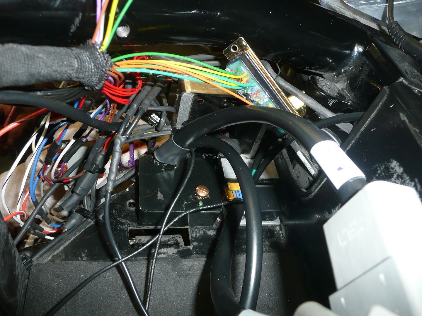

While John and crew was doing the wire plus, I was working on the sportster style key install. Drilled and tapped the two set screw holes, then installed the switch
Remounting the coil required the dremel to oblong out one of the mounting holes and shaving a little of the bottom side. Tight fit with the new key switch.

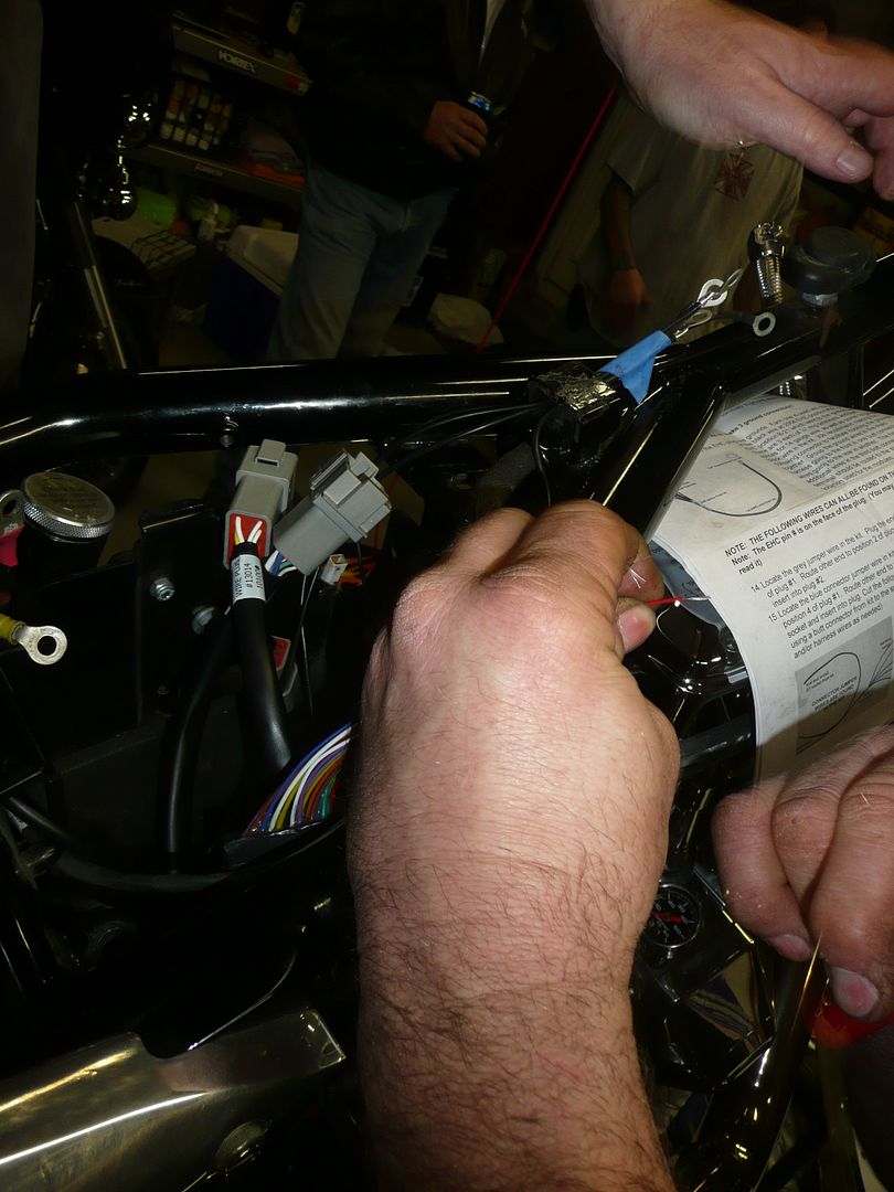

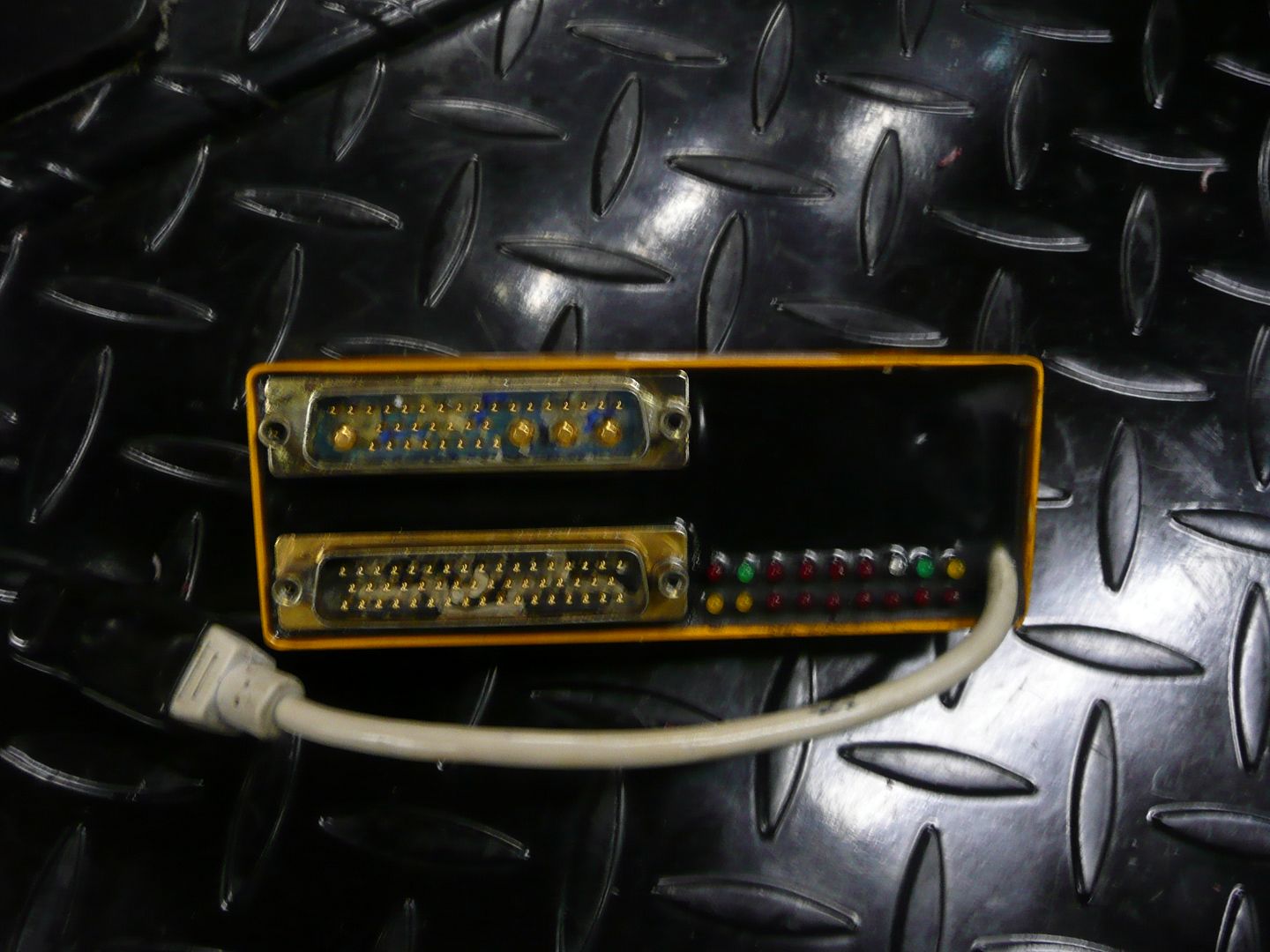

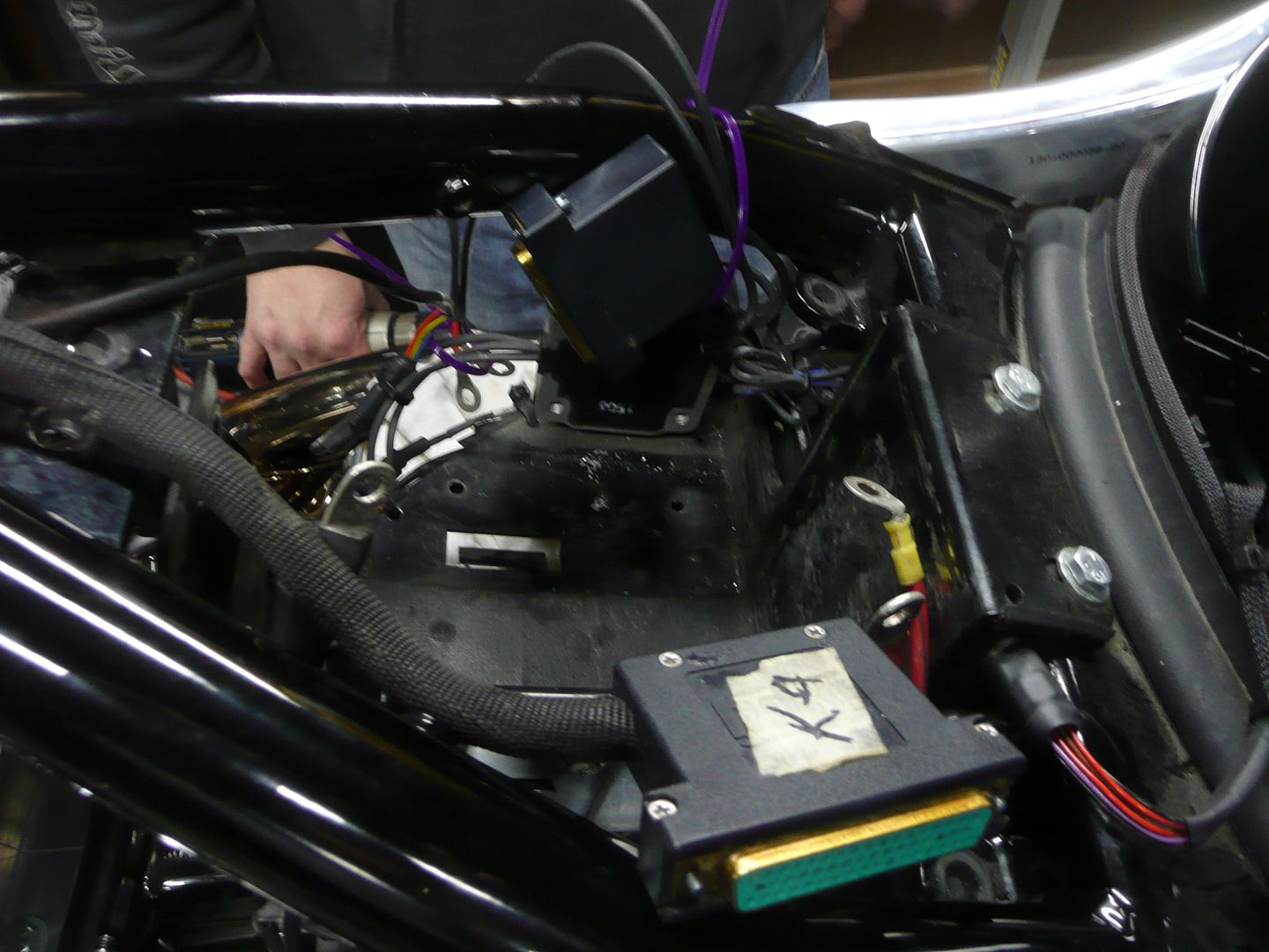

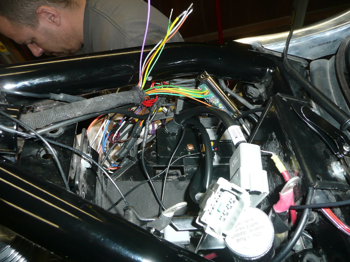

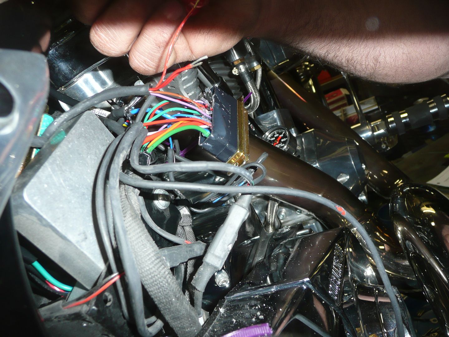

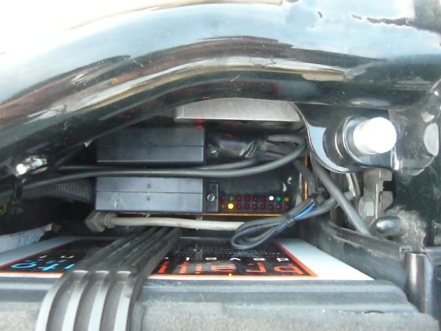

The boys got the wire plus modules mounted and started the process of wiring
This is a long and drawn out, time consuming processes. My hat's off to John. He was a MACHINE!!!

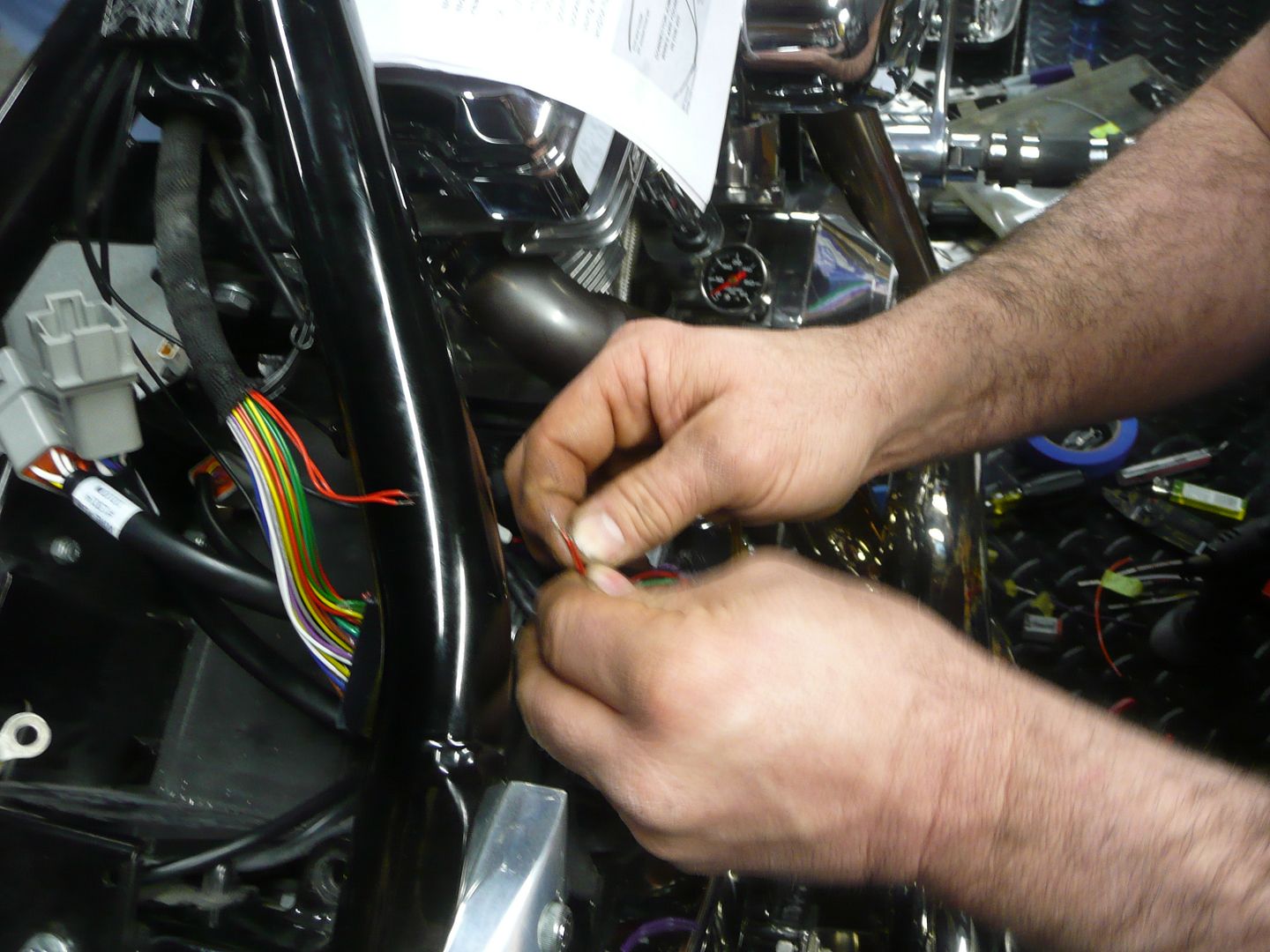

Not only was he testing wires constantly, but instead of relying on the crimp style of these pin connecting harnesses. He soldiered each and every wire.

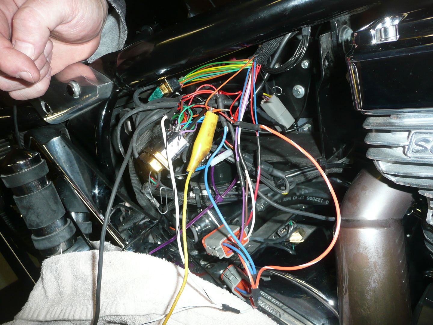

Next thing you know... John has the old EHC craptastic connectors disconnected and GONE!

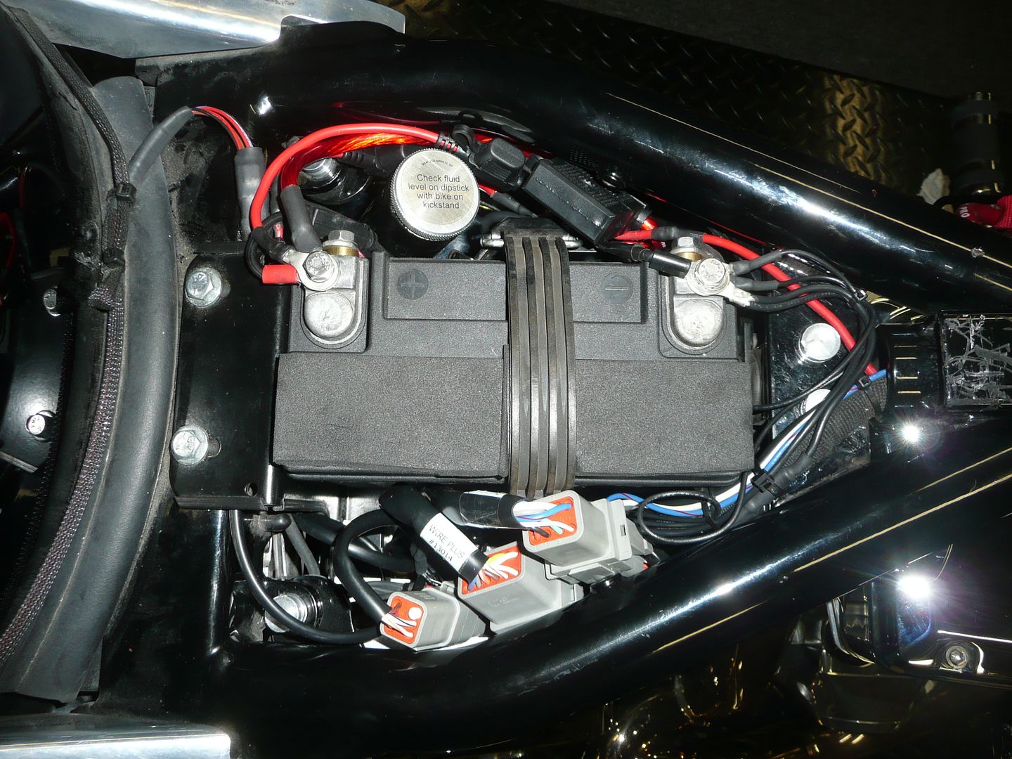

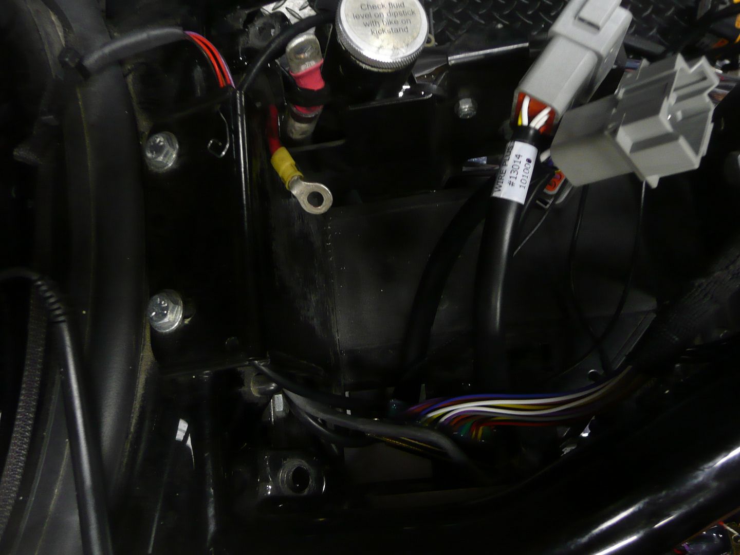

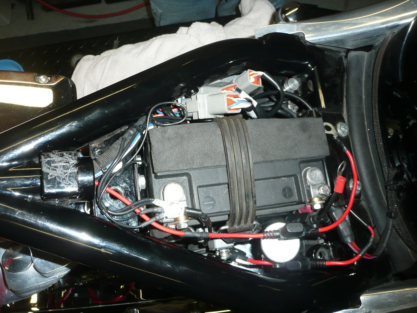

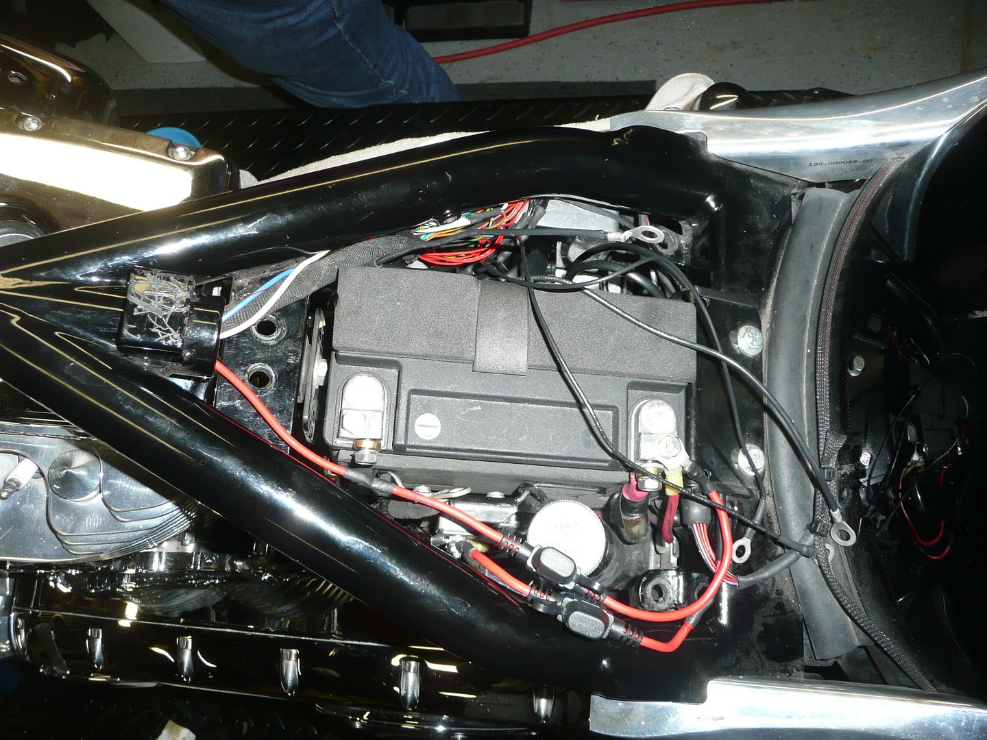

Buttoned up in the battery tray... finish up the wiring for the key switch

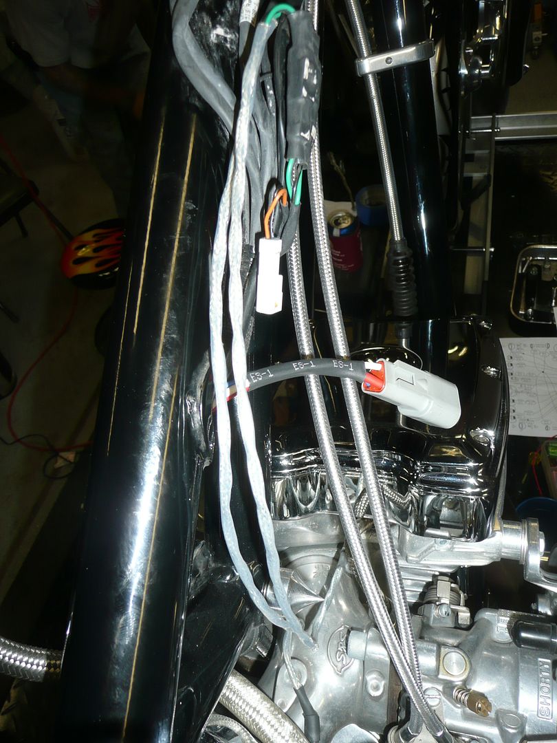

Wire fished from backbone to wire plus
Ran the new 30 amp maxi fuse in place of the circuit breaker and with that connected we hooked up the last wires to the battery
Tested the wiring job... I think John was nervous and Dave was completely confused! LOL

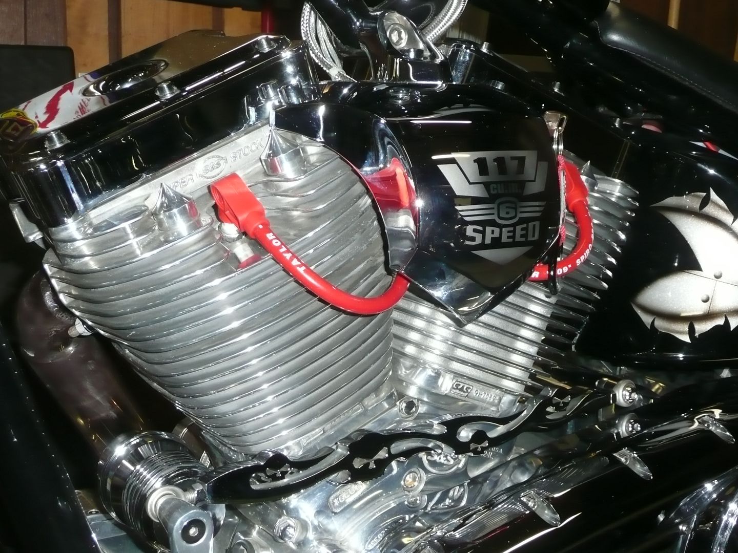

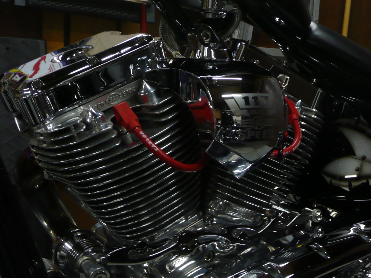

Trainguy (DJ) installed a new set of huge taylor wires and we got the gas tank re-installed.

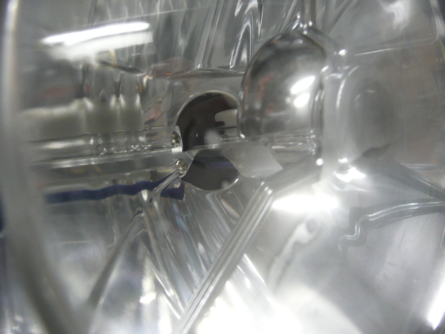

Later Dave & I installed a lowdownchopshop.com HID in his stock bdm housing. This is one of the few ever done with the adjure lamp. Take a peek.
Dave shows up...
