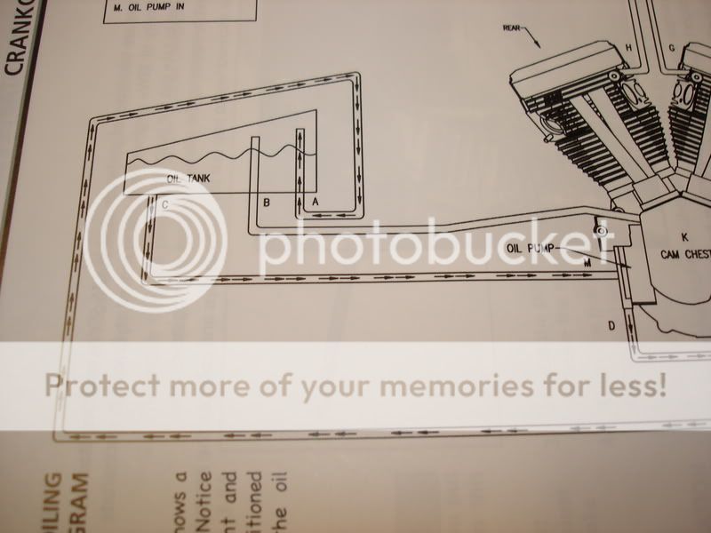

I replace the S&S teardrop air cleaner with a velocity stack, and the mechanic working on the bike at the time cable tied the lower crankcase vent hose to the oil line and it was open under the oil tank.
After the bike sits for a while, it will puuk about a 1/2 cup of oil out of this hose and then stop. When I questioned the mechanic he said it was normal???? I was just too stupid at the time.
I routed the hose to a small breather collector mounted down by the tranny, but it will fill this collector up!
I am running dougherty power vents on the upper breather.
I never had blowby when the vent was connected to the back of the air cleaner.
What could be causing this?
