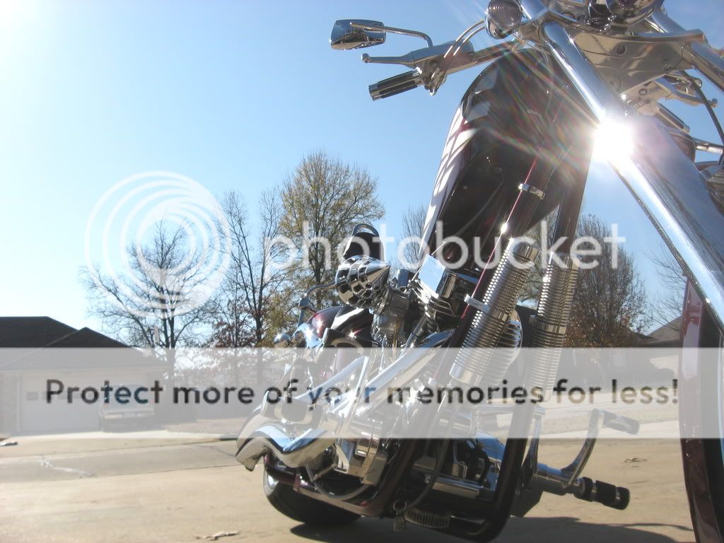

Would like to see pics.I have a dual oil cooler setup on my K9 but I have it setup with an automatic thermostat bypass for the cooler weather. Here in NJ it will bypass the cooler until the oil hits a certain temp then switch over to flow through the units. It is my local dealers setup not the big dog one.
Here you go there are other pics in my member gallery of the whole bike.Would like to see pics.
Yeah it is in chrome cost a pretty penny as all who deal with JC knows but seems to work well.Looks like a JC set up to me![]()
Excellent point! A thermostat is a must, keeps the oil temp in a good operating range. I believe that most thermostatically controlled oil coolers don't allow oil through the cooler till oil temp is 180 degrees.I have a dual oil cooler setup on my K9 but I have it setup with an automatic thermostat bypass for the cooler weather. Here in NJ it will bypass the cooler until the oil hits a certain temp then switch over to flow through the units. It is my local dealers setup not the big dog one.
You have a temperature gage? Just curoius what kind of oil temps you run with that set up.Main reason I went with it I instead of the big dog version. I also like the dual tubes running the frame instead of the short fat single tube BD uses.
