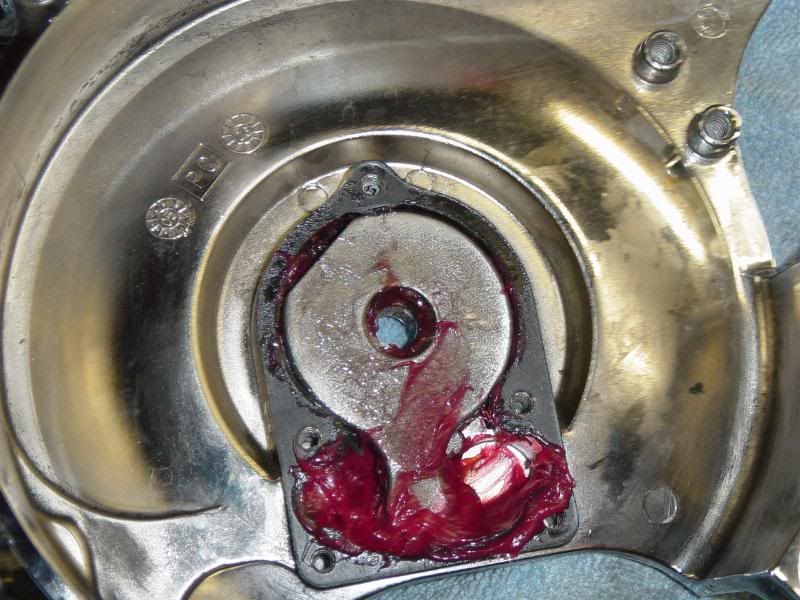

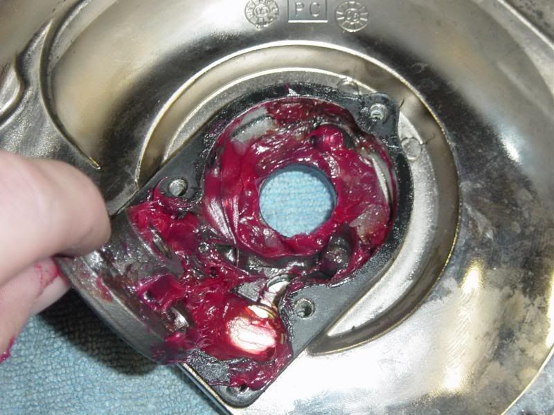

You can. Order the cable from Nelsom or Vicky and when you get ready we can talk you through it but it's easy and the hardest part will be the ball and ramp assembly inside the tranny cover.
Can't remember what pipes you have so can't tell you if you need to remove them but if they block the tranny cover then you will most likely have to remove at least the front pipe so get a new gasket for it.

Que, dealer may have misplaced one or more of the ramp balls in the actuator. Actuator has to be opened up to get the cable off, and they may not have put everthing back in place before they closed it up. And it is also possible the clip on the bottom side of the hand control lever is not right also. Just some thoughts that might help.:job:
