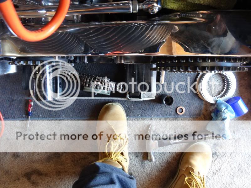

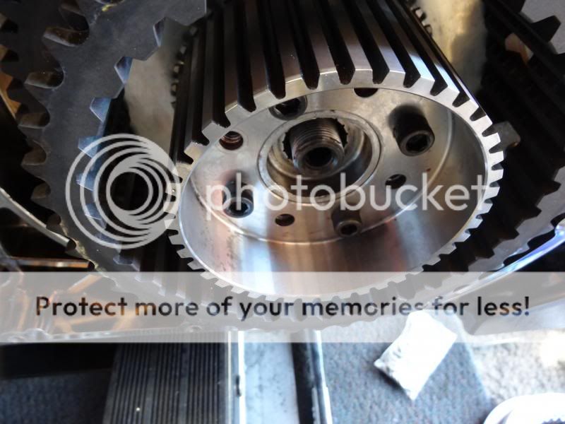

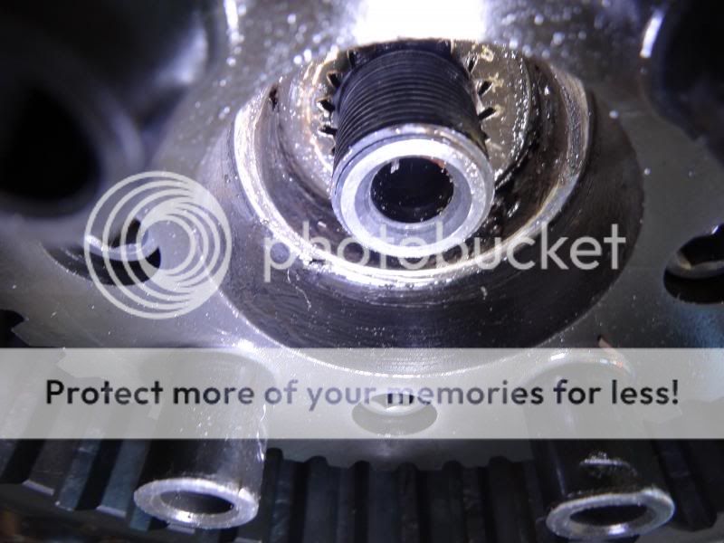

After following directions that were sent with my Bandit Clutch I reassembled the new ,provided from Bandit backing plate,clutch hub and basket and put assembly onto trans spline and it dont seem to go in as far as the stock basket,matter of fact if I look from above and use the inner primary edge as my straight line the primary chain gears dont even line up nor do I have that much thread left on the trans spline to run my clutch hub nut onto,its as though the hub is not going all the way on yet I am scared to death to run the nut on and then not be able to remove the assembly at all..I have a stock unit Trainguy sent me a few years ago and when I put that on it slides right in and theres plenty of thread on the spline of the trans and all gears line up properly...I mean they are the same hubs.....has anyone ran across this issue....any ideas??????? Below are pics
See how the gears dont line up...
Stock clutch basket,look at the amount of threads on trans spline...
This is the Bandit clutch basket very small amount of threads from the trans spline......:bang::bang:
