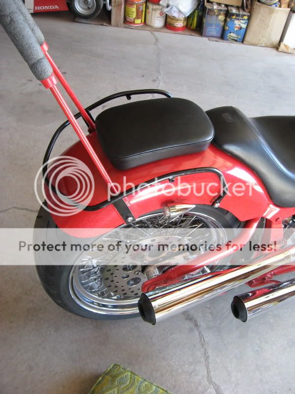

I know my red chopper I built is a little different than what most of you have but I think any of you could fabricate this setup for you Dogs by drilling JUST TWO holes in the forward part of your rear fender and then using your sissy bar as the rear attachment much like the BDM factory luggage rack.
This is the "clean fender look" on my bike which I wanted to be able to easily go back to.

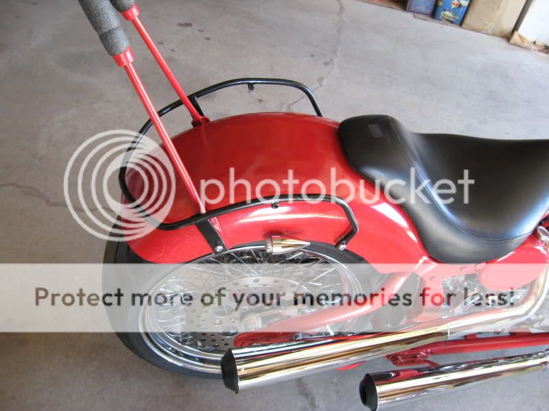

And here is the sissy bar on (just remove the back diamond accents to install).

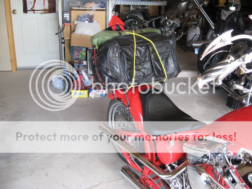

Most of you (like me) have probably wished you could safely pack more stuff for a road trip and still not damage your high $$$$$ paint job. AND NOT do like Bruce (one of our members) had to do in this trip report (thanks Bruce) to save his paint!

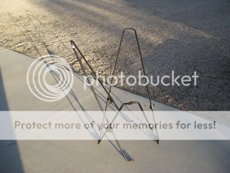

I started out with scrap iron half-inch rod (an old canvas chair frame I got from the thrift store for $2 bucks) and some smaller rod (same source for $1 buck). Material cost less than $5 bucks plus quite a bit of time. What is in the picture is what I have left (I only used two short legs). I used the natural bend and holes on the one end of the rail.

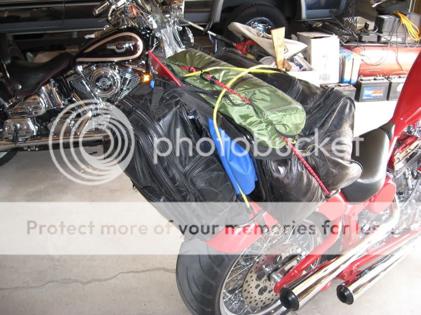

Here are the "loaded" pics. Very easy to stack and attach the bags, tents, small chair, etc.

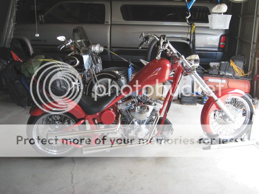

![](/proxy.php?image=http%3A%2F%2Fi276.photobucket.com%2Falbums%2Fkk40%2Fshovelcowboy%2FDCP_1248.jpg&hash=99d743131f00107a9bd0fcf079e0ba7c)

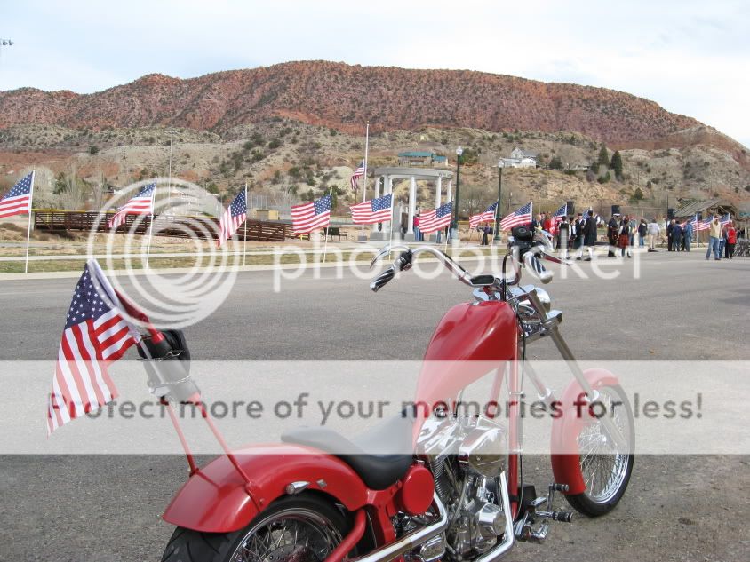

![](/proxy.php?image=http%3A%2F%2Fi276.photobucket.com%2Falbums%2Fkk40%2Fshovelcowboy%2FIMG_0957VetDay09chop.jpg&hash=3503254be29ba5e08da94de1fd357b89)

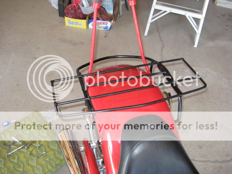

Next I built and welded a top rack (which is easy on - easy off with just two bolts).
![](/proxy.php?image=http%3A%2F%2Fi276.photobucket.com%2Falbums%2Fkk40%2Fshovelcowboy%2FIMG_1339railrackfront.jpg&hash=3f5d3bb03940ae79453e8fcc3c5abaaa)

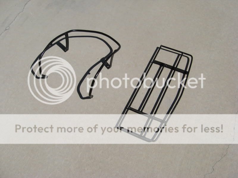

Here are the two pieces off the bike (just painted). I will get them probably powdercoated black or chromed.
![](/proxy.php?image=http%3A%2F%2Fi276.photobucket.com%2Falbums%2Fkk40%2Fshovelcowboy%2FIMG_1335rackoffpainted.jpg&hash=f73ff6333607e86135cecef21bdbb0ea)

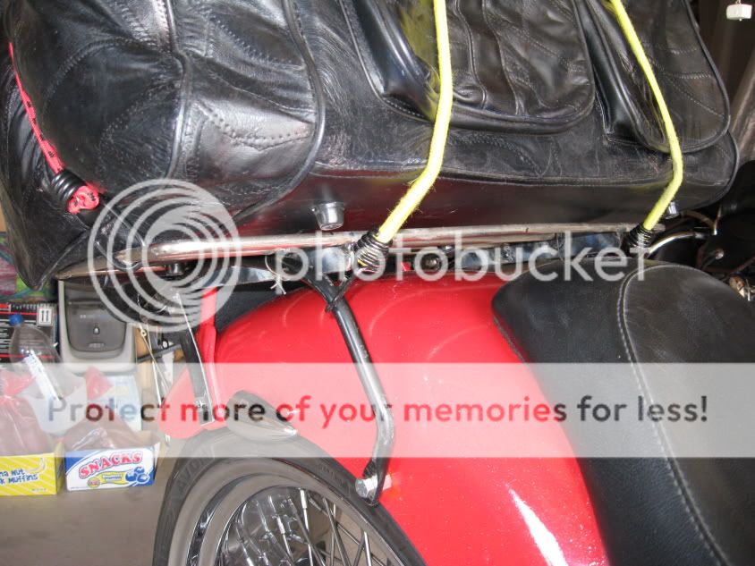

![](/proxy.php?image=http%3A%2F%2Fi276.photobucket.com%2Falbums%2Fkk40%2Fshovelcowboy%2FIMG_1328loaded1.jpg&hash=02dea3fca672cd26f3887d4e9614ce4f)
![](/proxy.php?image=http%3A%2F%2Fi276.photobucket.com%2Falbums%2Fkk40%2Fshovelcowboy%2FIMG_1329loadedfromfront.jpg&hash=550df63c7c3f0be3f3a5023c5b7a2884)
![](/proxy.php?image=http%3A%2F%2Fi276.photobucket.com%2Falbums%2Fkk40%2Fshovelcowboy%2FIMG_1331loadedabove.jpg&hash=f9426424f90908c513228a1e3cf44d49)
Under shot before painted. You can see how everything is "OFF" the fender.
![](/proxy.php?image=http%3A%2F%2Fi276.photobucket.com%2Falbums%2Fkk40%2Fshovelcowboy%2FIMG_1330loadedunderview.jpg&hash=571e1903ec57c8f9c1804631392eb422)

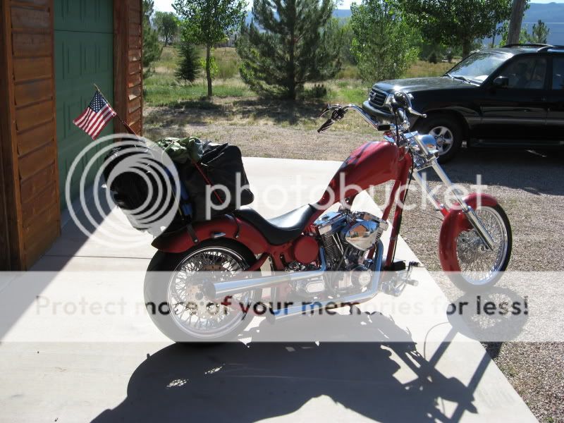

And a shot before a test trip on the 4th of July with the bike loaded. Handled really good and center of gravity was kept low. There is just enough room in front for my leather jacket (or whatever for an "easychair" backrest).
![](/proxy.php?image=http%3A%2F%2Fi276.photobucket.com%2Falbums%2Fkk40%2Fshovelcowboy%2FIMG_1343luggagerackloaded.jpg&hash=29ed0550f3ac2bb926ca43cc60bb4f43)
