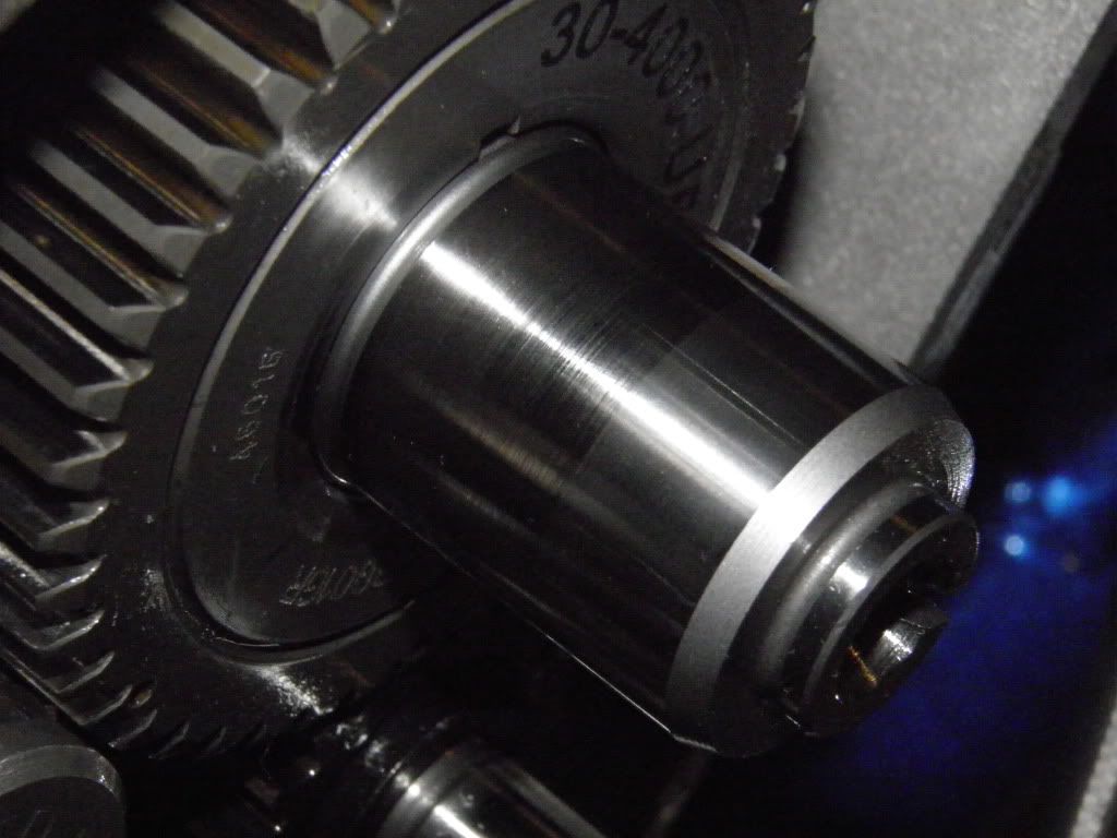

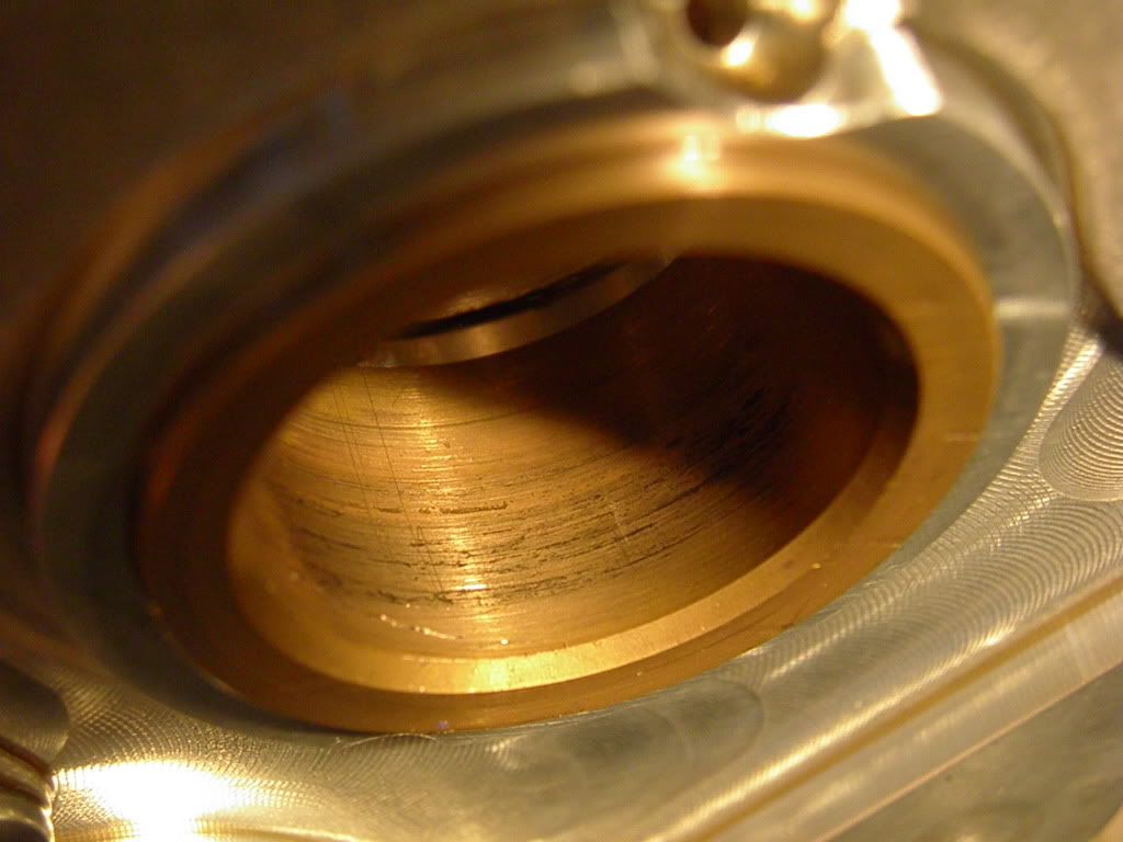

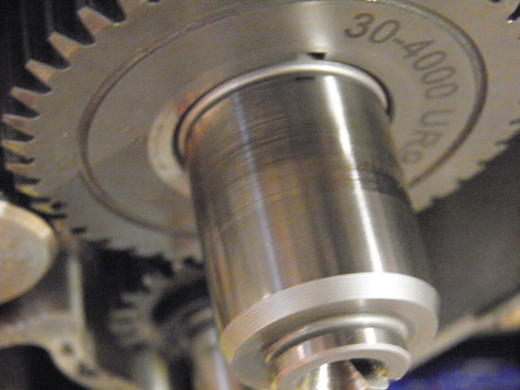

Run out was my next step Marv, thanks! The cam needle bearing looks good and is the Torrington. In the mean time this is what I have found. Looks like my cam and bushing have significant grooves worn into them. Now the question is what's causing it?
END OF CAM SCORING
END OF CAM SCORING
CAM COVER BUSHING
Bowhunter
Brian, I am assuming the photo is of the bushing in the cam cover and the end of the cam. It appears that the bushing may be the cause of your noise. If so, its time for a new cam and bushing. That would be a lot better than the crank bearing and a full tear down.
