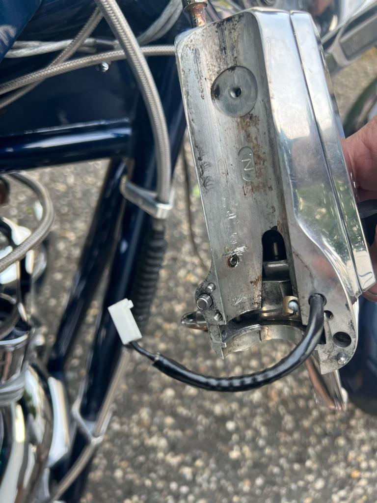

Hey brothers and sister how do I remove this switch wire and where can I get a new one?
There is a very small set screw that holds the brake sensor in place, but it looks like someone put something else in there. I'm not sure what the deal is there. You can get a new sensor from bigdogpartskingpin.com, but it looks like that one is in pretty good shape. Do you still have the magnet in the brake lever? Maybe it is missing or needs replaced.

Thats a throttle ferrel Slick! :oldhardlaugh: But you are correct, its a tiny set screw that holds it in.

Yes magnet is there. I took the wire cover off and someone had the wires connected wit tape and on side was loose. Brake like working now but now my neutral light stays on and when I press the left blinker it goes on and off with the neutral light. What good that be? Thanks man

Your neutral light blinks with the left turn signal?

Yes they are alternating I had some moister in the Speedo from washing the bike. could that be the reason? The needle goes the the middle when I start the bike and stays there then goes below zero and back to the middle. I don’t know what’s going on lol

Yeah, I'd say that is a possibility. Give it a couple days to dry out and see what happens.
