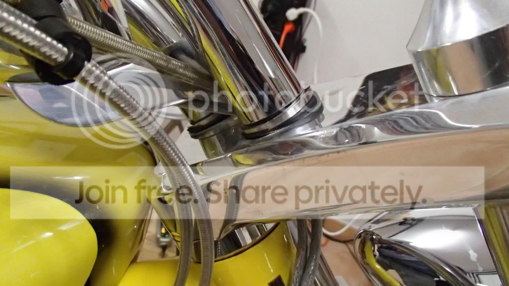

Today I´ve noticed the throttle cables were touching the tank... then, after further inspection I also noticed the handlebars do have a little bit of "up & down" movement.... :confused:
The bolts underneath are tight... but the rubber inside seems to be out of place or broken?
I need your opinions/advice please...
Thank you :cheers:

1. Replace the bushings on the handlebar with new ones, polyurethane preferably.
2. Cut that tie wrap with the fuel hose in between them, and keep that airplane mechanic wannabe away from your bike, you should be all set.
Yup, I went with the Polyurethane ones and Puuurrfect!!!! :2thumbs:
