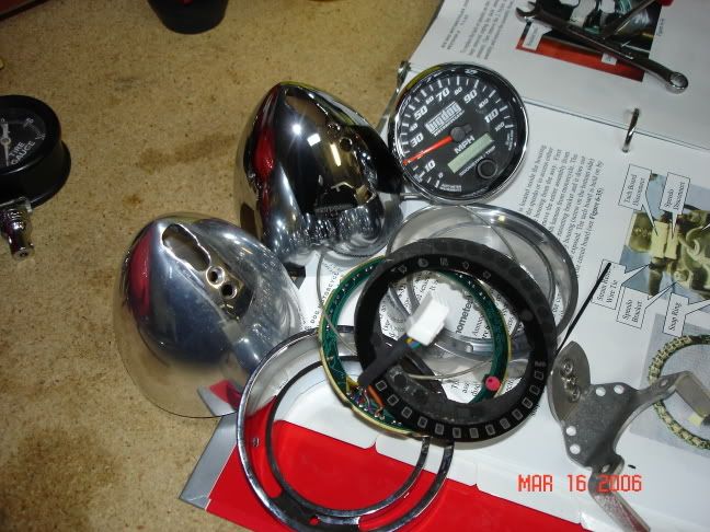

How do you get the speedo out of the housing. I took the speedo off of the bracket but could not get any further
Does anyome know how to get the speedo out of the housing so I can check to see if the wires are loose. See pic attached
Remove it from the bracket and you will see the two bolts that allow it to fall apart. Call Nelson for a service manual, it's all in there!!
