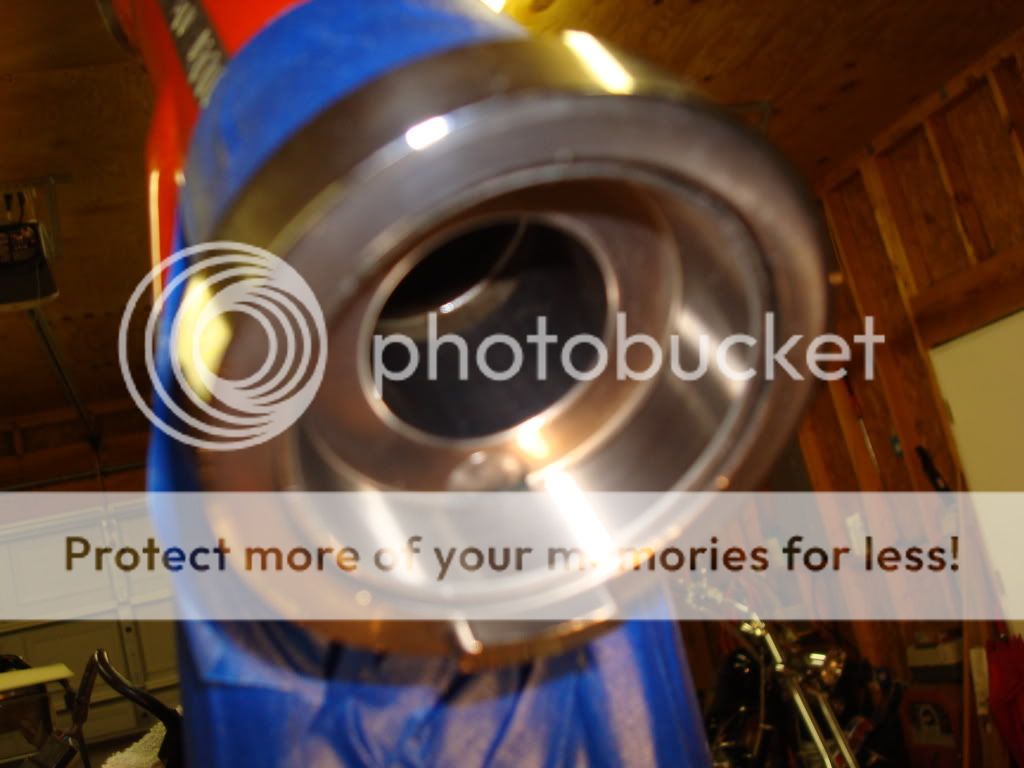

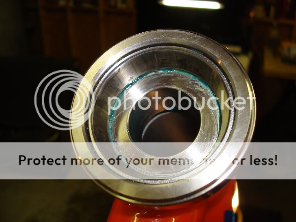

This is what I did to remove the outer bearing races from an 06K9. The forks and trees were already removed. I made a tool to tapped between the the outer race and the bearing cups and got the races to move enough to get a rolling head pry bar underneath. Then using a drift and hammer tapped against the prybar, they came right out.
Old bearings still seated in the neck bearing cups. Notice the damaged bearing races looks like corrosion.

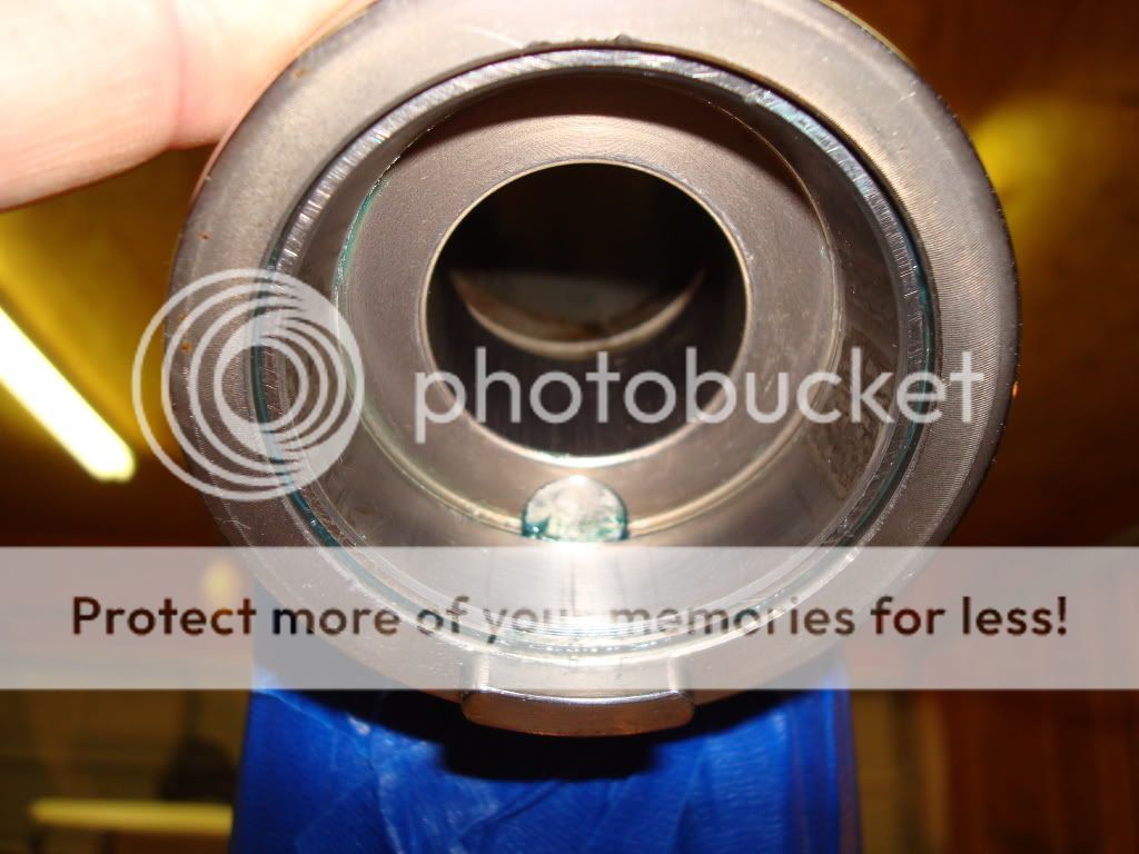

Bottom

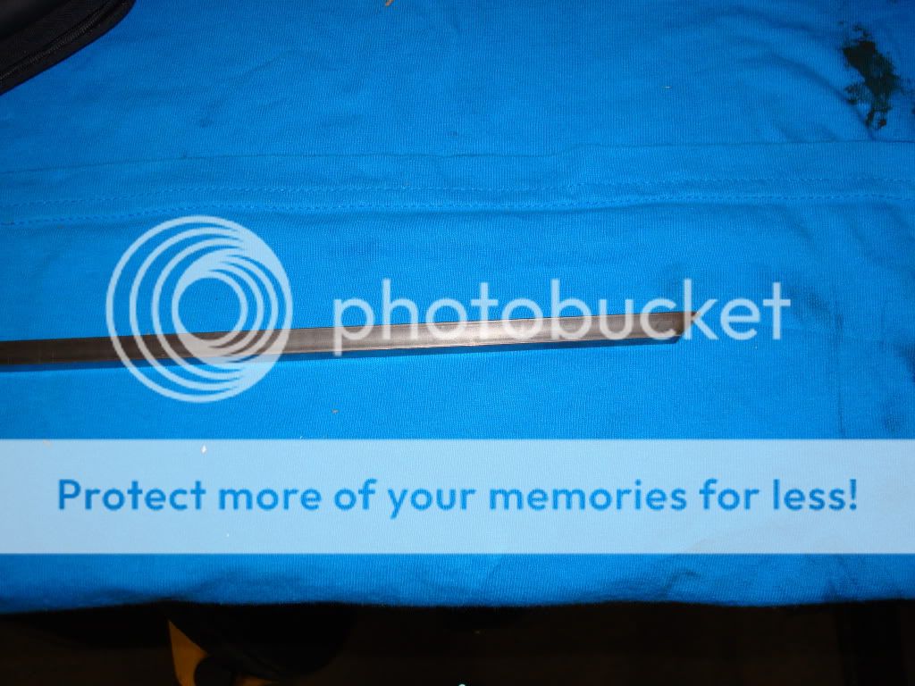

Tool I made from 3/8" key stock ground down into a wedge.

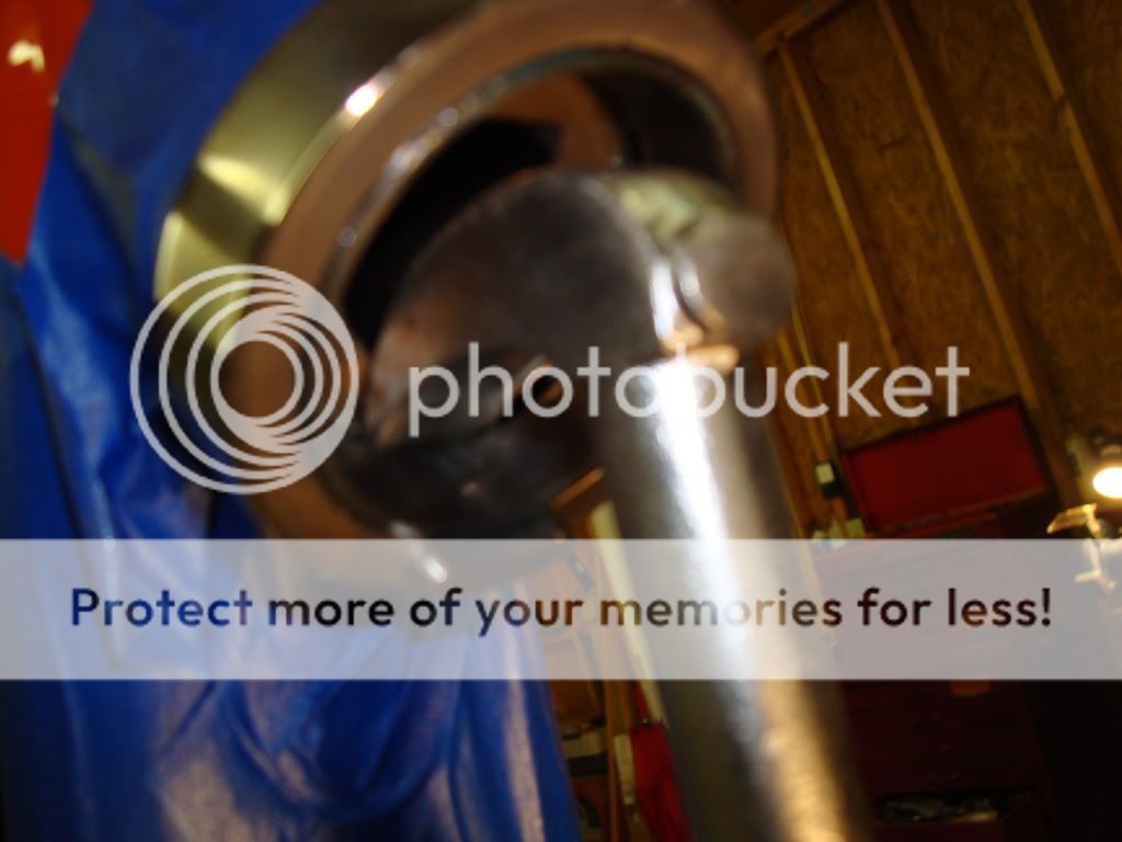

Inserted between the race and the bearing cup. Tapped around and around and it moved out. Be patient with this and careful not to damage the bearing cups.

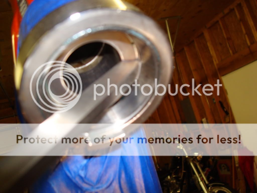

Now enough room to slide the rolling head pry bar under. Now use a drift pin long enough to slide down through the top and tap against the pry bar, working the bar around the race. Again be patient and careful not to damage the bearing cups.
