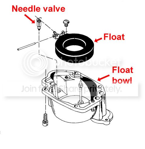

A stuck needle valve (float) in the carb could cause this especially if you didn't turn the gas off after the last time you rode...

The needle valve I'm talking about is in the carb...
You'll have to take off the float bowl to get to it. But, if the bike runs good (not rich and coughing) after you do the oil change you may not need to do anything right now. My thinking is if they were super reliable there would be no reason to have a shut off valve on the gas tank but there is... so what does that tell you? The needle has been known to stick on occasion but I would open it up sometime in the near future just to check it out. Afterall, you know if were to happen again it'll be at the most inopportune time!!!
