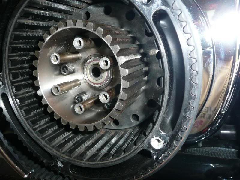

So does this look like its wore out to you guys? It hasn't been slipping and it's shifting fine.

The wear on the clutch basket I feel is acceptable. If there was clutch creep I would be concerned - since that was not the case I would say you could safely overlook that.

My clutch basket doesn't look that bad and really I think its in good shape considering its been on there for 4 years now.
