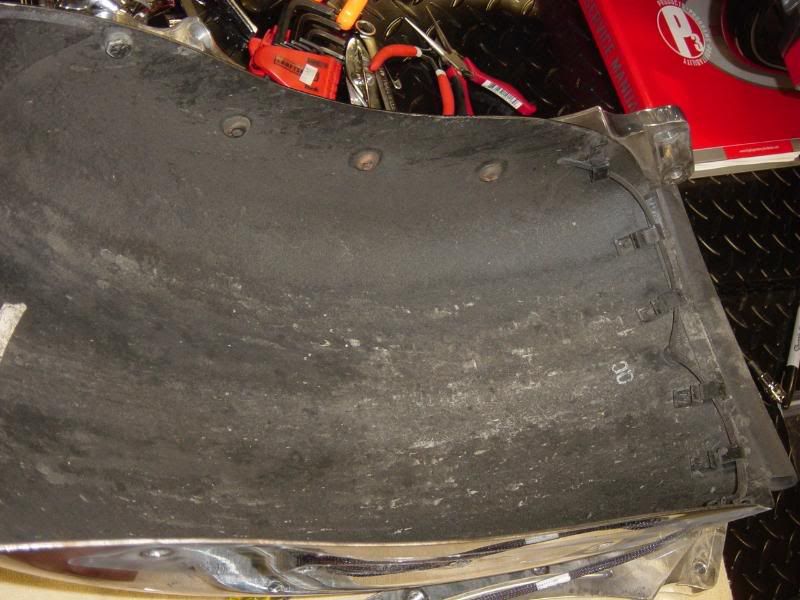

O.K., I think I'm witnessing my first BD electrical issue....as some of you might know, I just picked up my bike last Thursday. I've only got about 45 miles on my bike, but as I was riding today, I noticed my oil and neutral light would light up as I squeezed the front break or stepped on the rear break....is this a common issue? All experiences are welcome...

shouldn't have anything to do with the braking unless the forward motion is possibly causing a wire to touch in the speedo bucket, possibly a break in the circuit board. contact your stealer with the complaint.:2thumbs:

woodbutcher is right......if you are already having some type of electrical problems...and you don't even have 100 miles on it.....have your dealer come pick your bike up and let them go through it......
Even though yes it is a dealer issue. I bet you havin a chappin issue with the wires on the rear fender.
Those clips on the right holding the wire can come loose then your rear tire rubs thru the wires causing problems. This area is the only place where your front brake switch and rear brake switch are joined. This has happened before to other people. Simply pull one of the fender strut bolts on each side, loosen one of them on one side... so you now have one of the four still in and tight and one on the oppisit side loose. Now with your hand on the fender, loosen the final bolt, swing the entire fender up and then re-tighten it, which will hold the fender up. Inspect those wires as my pic shows.
Now the problem could also be in the rear taillight housings as well.
RRRUFF
Just another thought I had a similar problem but I had moisture in the EHC connector which was causing a short between some of the pins in the connector. This happened while riding in the rain.

The vibration on these bikes can loosen connectors or rub wires..
