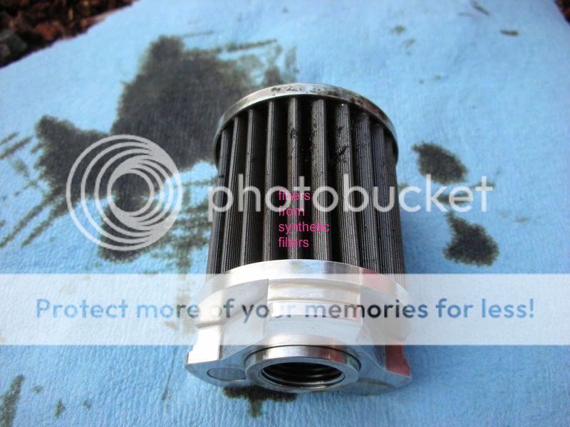

I will tell you that if you get it you will notice a lot of paper fibers getting picked up the first few cleanings. I blew out paper fibers for the first few cleanings and these came from paper filters. The BDM company knows I have had this filter due to my oil light problems I've had in the past that were traced to a grounded wire under the tank so no warranty lose or anything like that.

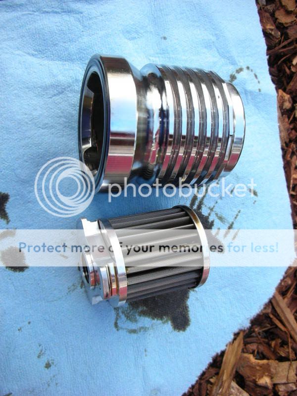

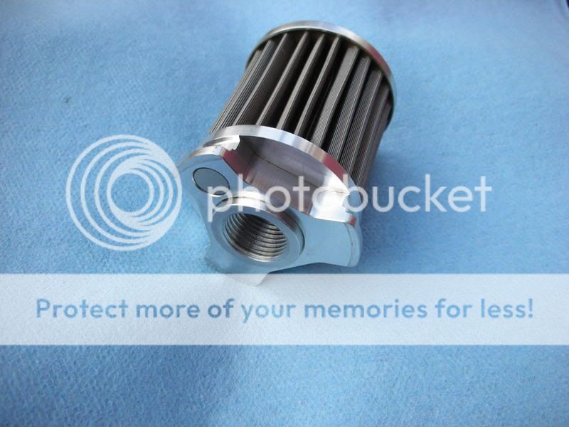

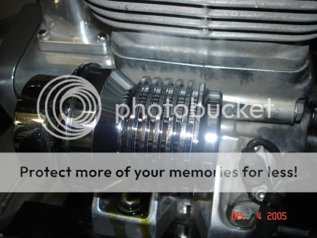

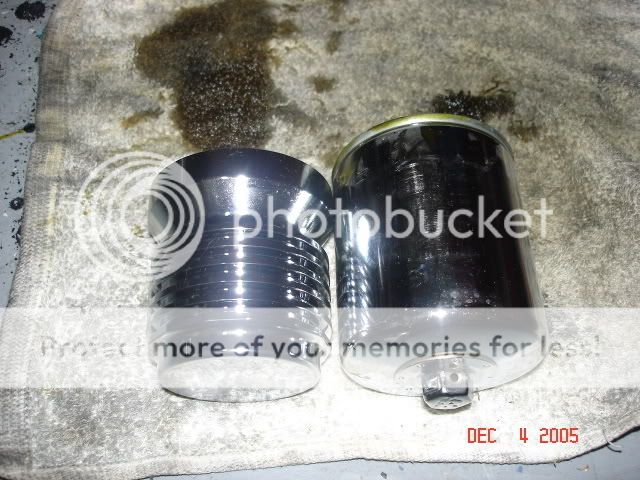

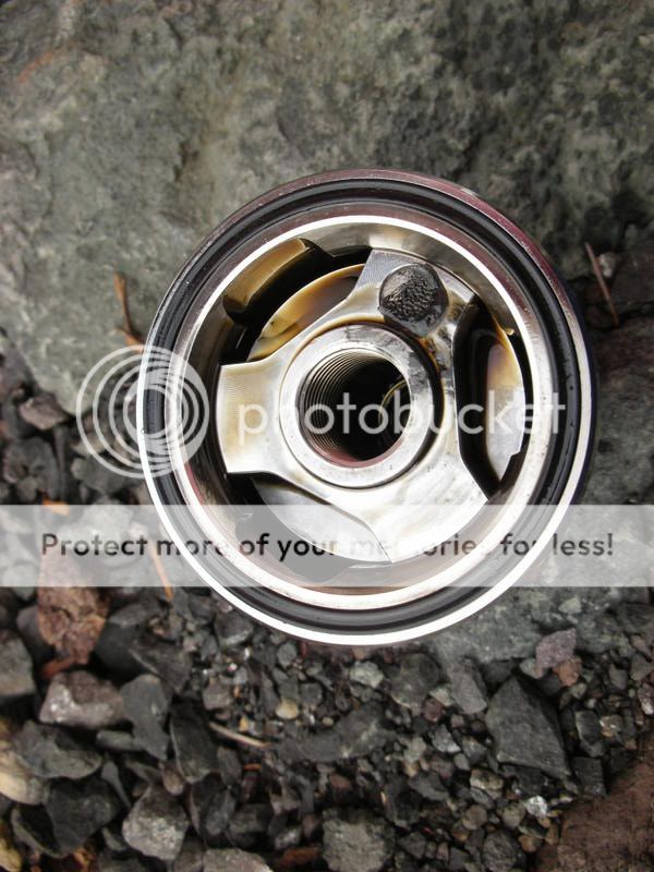

Here are a few picks of the filter.
Get one,
Ray
The S-4 this fits all our dogs and HD's

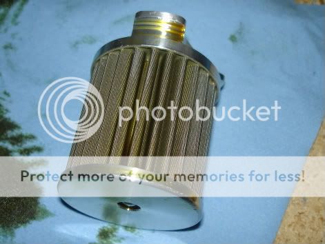

Here is the pictures from the website with the filter wrench that comes with it. It needs a 3/8" ratchet.
Here is a pic of the paper fibers it picks up.
Get one,
Ray
