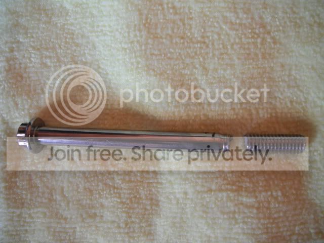

Anyone running Stainless Creation Chaos II pipes? I've snapped two of the exhaust mounting bolts within a week and was curious what size you were using. I'm currently using 5/16 X 4 grade 8 and they keep snapping about an 1/8 inch into the threaded area.

After tightening the exhaust flanges first, I came to realize that the mounting hole on my exhaust bracket mount was about a 1/4'' off from the mounting hole on the trans mount bracket. With the holes being so far off, it was basically pulling up on the trans mount bracket. The pressure along with vibration was causing the bolt to shear off. Swapped out to a smaller diameter bolt for the exhaust bracket mount and no more pressure on the trans mount. Went on a ride for about 3 hrs encountering a few rough rodes and no prob with the bolt. Yeah!!! You would think that after close to 1K for pipes that the mount would be the last thing you would have to worry about.
