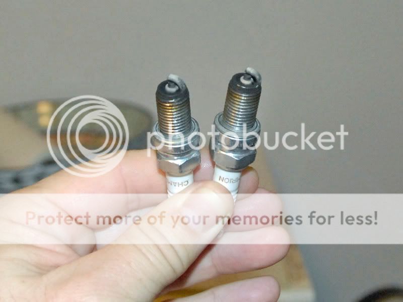

...Check the plug color. The insulator should be a tan or lite brown The ground part of the plug (with the electrode) should be black but not sooty. the electrode sould be clean and possibly a bit whitish from the bend in the electrode to the base of the plug.
Most important, both plugs should look the same.
If the plug color isn't balanced (one plug white and the other black and sooty), you could have an intake leak between the intake manifold and the front or rear head. The plug with the lightest color would be the cylinder with the problem.
Here's what my last pair looked like:
