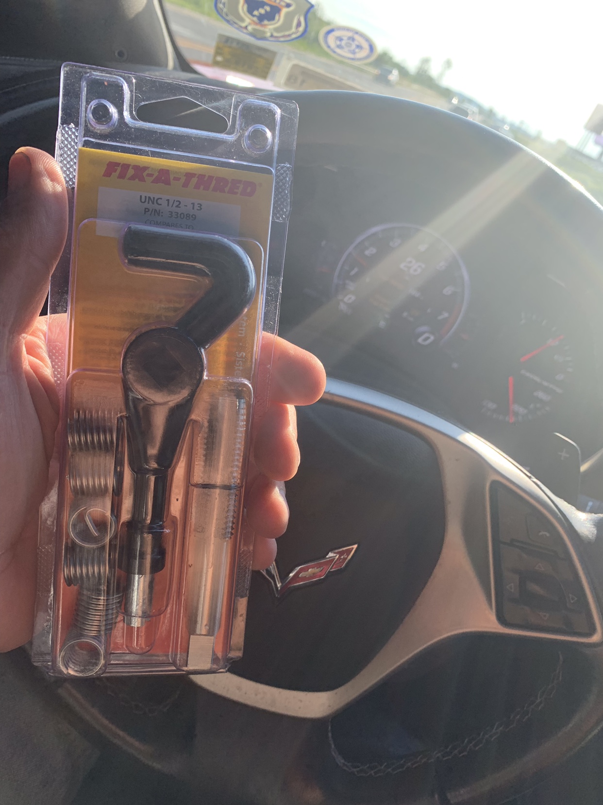

The locking nut? Yea it's mandatory. Why won't it go on? Threads got chewed up?
Was texting with CD this afternoon, sounds like the threads on the pressure plate are messed up. I suggested using a helicoil to fix, he's gonna try to find one local.
