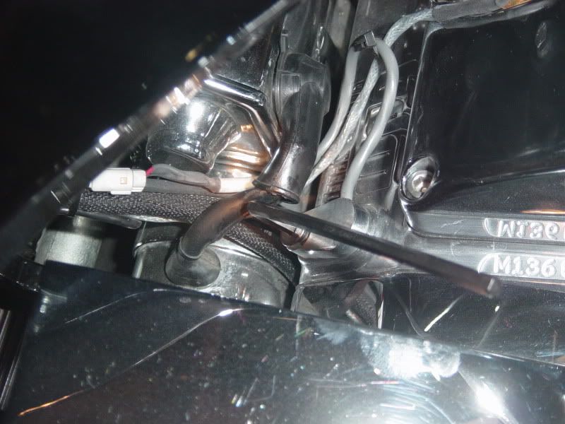

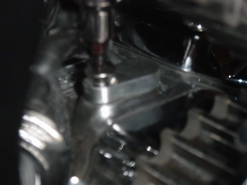

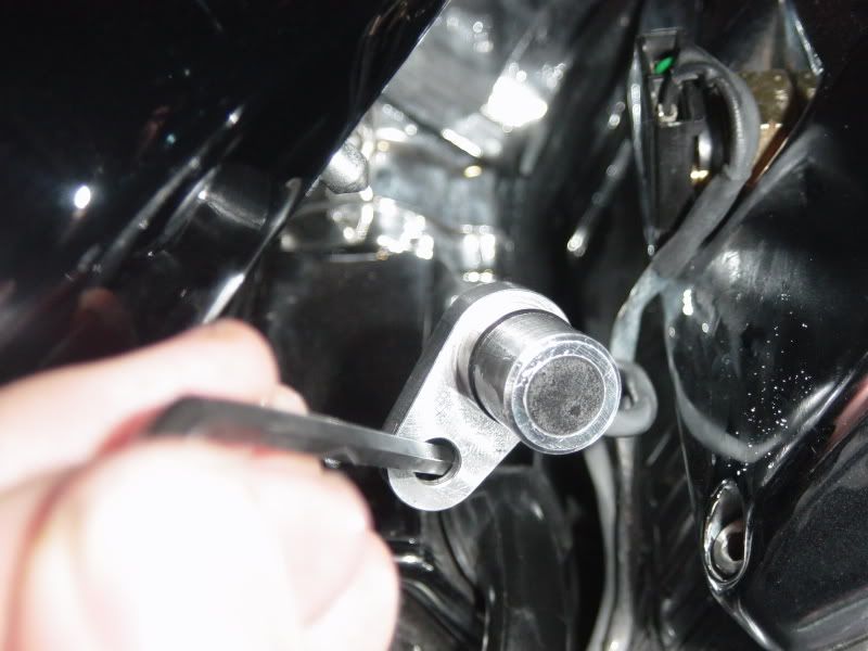

where is this sensor located and what is the best way to clean it?
Perhaps this belongs in the "How To" section.
It's the little oblong piece you see on the right side of the tranny. It's just a motion sensor and you are supposed to pull it and clean the surface every now and then. One small bolt holds it on. Gas Man posted it somewhere. :cheers:

Yeah I think I have posted these pics more than anything...
Here's a few of the sensor and what it will look like when you pull it out. Just clean off the end that was in the tranny.
