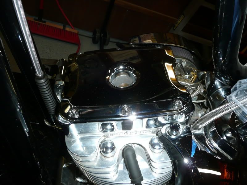

How? I've seen motors with manual switches, on the side, near the plugs. Are you saying to push in the covers on top of the rockers?
Sorry for the dumb question - never had a compression release bike before...

na Frank.....thats not a dumb question......I never knew what those were for either....til I joined this forum:lol: but yes....you push in on those covers on top of the rockers if you want to do the compression release buy hand..

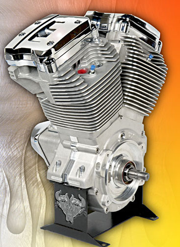

Lambo...those are the cheap releases on the sparkplugs. The real ones are the hole in the center of your rocker boxes. They are electric but can be pressed manually...
Here is a pic of the manual compression release Lambo is talking about. They either are tapped in on the side of the sparkplugs or on the oppisite side of the heads.
Or the sparkplug ones;
My Bad Lambo......these ones that Gas posted were what I thought you were talking about.......
