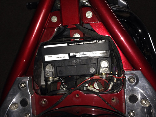

Hopefully an easy one for you all. I am trying to replace the battery on my 2008 Pitbull and need assistance. I have the seat removed, but the battery has a rubber band over it holding it down tight. I think I need to remove the battery side covers in order to release/loosen the band, but don't know how. Any input is appreciated.
Alex
BWG56
Just stretch the strap to one side and unhook the clip down the side of the battery that your stretching it to.
heems
I had searched on the forum site, but go figure, as soon as I posted I did another search on google and it pulled up http://www.bigdogbiker.com/forums/help-wanted/17622-2008-pitbull-battery-removal.html
There are 4 screws - two towards the front and two towards the back under the black plastic inserts. The strap is solid steel (covered with a thin rubber band) so no stretching possible. One side of the band ties via the lug nut as shown in the post above.
Now to find a good inexpensive battery... :)

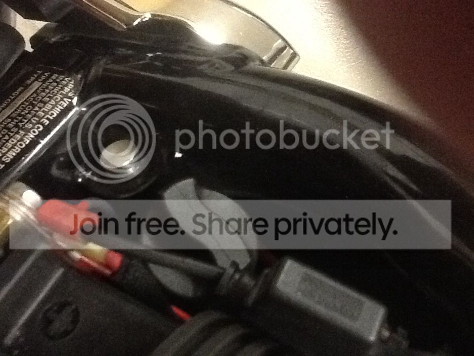

Not to hijack this thread, but... If I have to remove my side cover how to I remove the studs shown in this picture. My service manual shows bolts not these thingamabobs. I've been afraid to pull up on them too hard.
Dawgboy
Just pull them up. They are held in place by a rubber grommet. May want to put a little lithium grease on them when you reinstall
