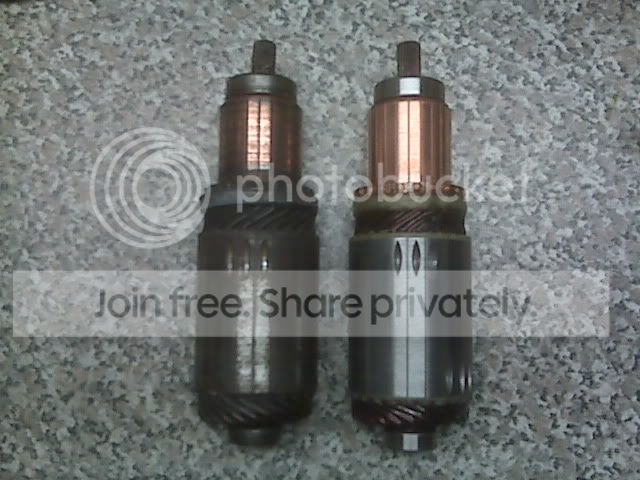

Ok got the armature in and I swear I think it is the exact manufacturer of the original armature because they are identical.
I also changed the starter motor case O ring from a .06 to a .07. The factory O ring was not sealing to the case which allowed water into the strater motor and ruined the bearings and corroded the brush plate. I am also going to add the mod for the oil return as I think that is a good idea.
