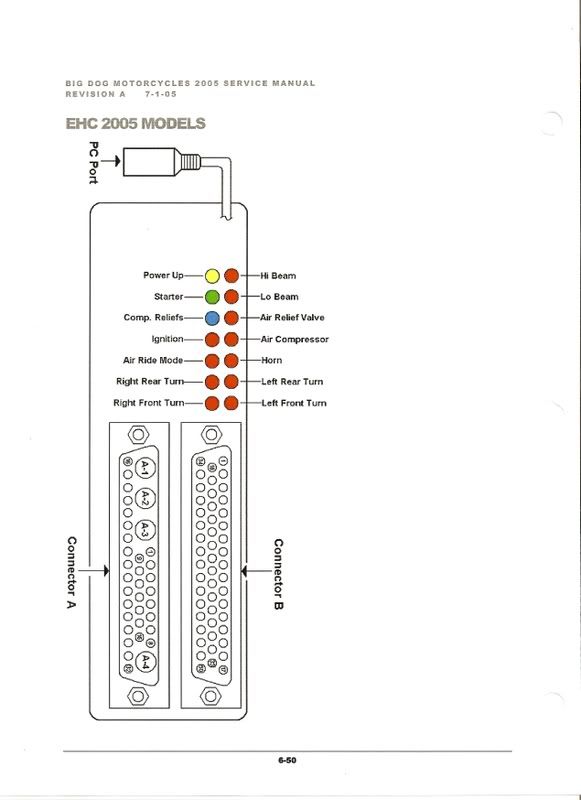

i record it on darkness cause in the day the leds werent noticeable. the led that is on is the upper 3rd from left to right no starting engine,then it changes to the 4th and the bike starts.
when it dies all the leds go off, not the lights, nor the turning lights, nothing at all, just the leds. and when hitting the start button , the 3rd led goes on..... and have to wait until the 4th is on and start the bike.
yellow and blu lil lights are from the ignition.... yellow in the right is the ignition led of my EHC.
any help????
Which EHC do you have? Red lits are fault lits. 3rd and 4th lights are air compressor and air relief. Do you have air ride on it?
Still seems you have a loose connection somewhere so I would pull the harness' and ensure the EHC is full of die-eclectric grease and reconnect them ensuring a good connection. Same with the battery cables.

The EHC you have was built two ways. One was with hard potting material and the other with soft. The hard was part of the EHC recall, the soft was not but I think some of them could have had the same issue. What you discribed to me sounds like a solder joint issue on the ignition FET on the bottom of the board. As it heats up it expands and the connection (on the circuit board) becomes loose. Once it cools down you can start it again, vibration could play a role as well. Sorry to tell you but if this is the case you are looking at a new EHC. Make sure to double and triple check the ignition key and ignition module before you go thru the expense of an EHC. I could build up a little pigtail that would allow you to hard wire your ignition module (thru a deferent switch), if you continue to have the issue it is the ignition module, if not you can bet it is the EHC. The fact that you can cycle the igntion switch an it does not help tells me you could probably rule out the ignition switch. Wiggle the hell out of it to be sure and see what happenes. You could bypass that one as well to rule it out.

thanks Mike, helpin as usual.... Gas Man is sending me a stock ignition module... so ill let you know.
