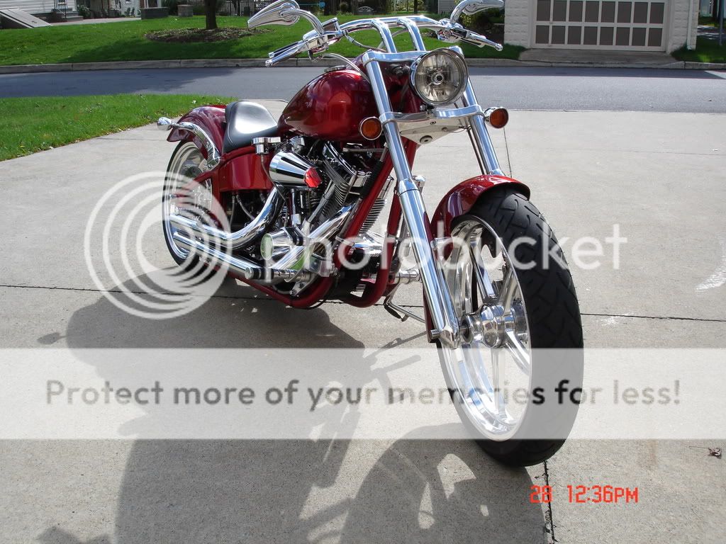

Anyone know what would cause my turn signal to flicker on and off ? It's not the switch as the rear does not flicker. Front and rear blink ok when activated , but front left continues to flicker.
