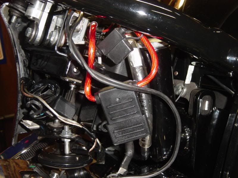

Sun_Bill, I'm still surprised you have circuit breaker on a 2007 K-9. They were not part of the Voltage Regulator recall, and at that time they should have all come with the circuit breaker, right near the battery. It would be a small box with a reset button on the bottom.
Can you take a picture of the circuit breaker you are referring to??
I see from Chuck's pic and what Ray is saying... they are running a standard ATC
But Ohmster himself said that he prefers MAXI fuses which are larger. he says they are more reliable. So that is what I ran. The large one is the MAXI and the other is a ATC for the battery tender.

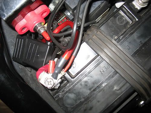

Wayne,
The large plastic rubbery box on Gas Man's e-mail is what I was referring to...mine looks like that, and the fuse is located inside that plastic rubbery box. There was recall on this? When I bought the bike, the dealer specifically ran through how to carefully charge the bike with the battery tender...pull off the wall first, than from the bike. If I unplugged in the wrong order, it may blow something out he says...could you give me more info on the recall?
P8RIOT
The recall was for older bikes, 2005 and 2006 - it did not apply to our 2007's. I'm still surprised you have a fuse rather than a circuit breaker. :confused:
05chop
I think P8RIOT Means circuit breaker rather than a fuse sun bill you are fine if you have the fuse.
