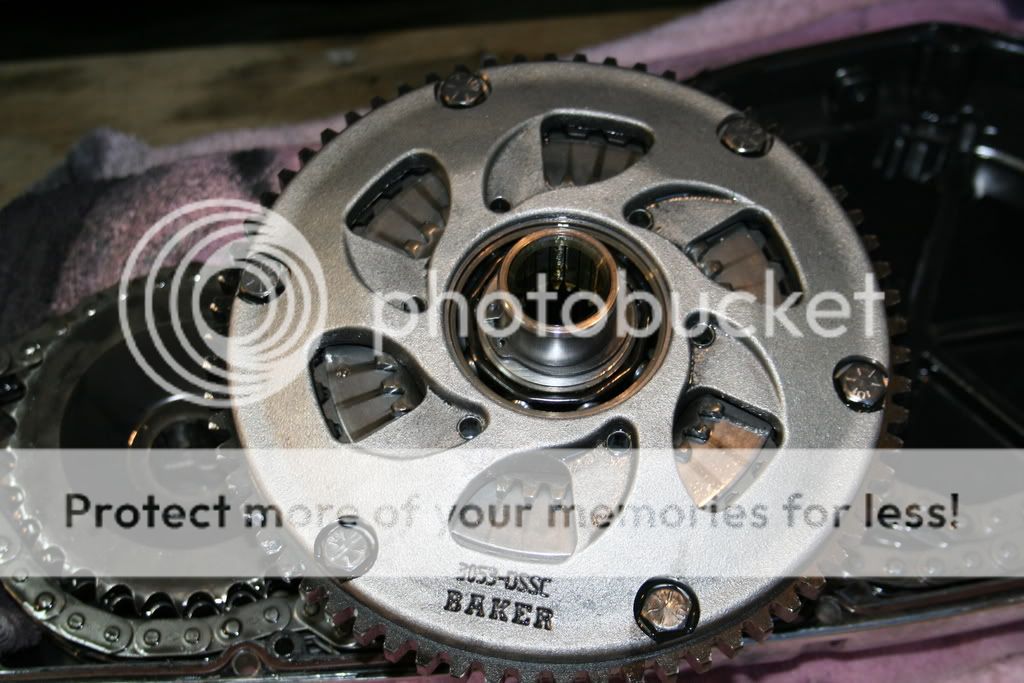

I am fucking pissed, Damage from a loose nut on the clutch assembly from before I bought the bike. Now the trans input bearing is shot! So much for Daytona. Glad I caught it before the whole trans took a shit but I doubt I can get it back on the road before Daytona.

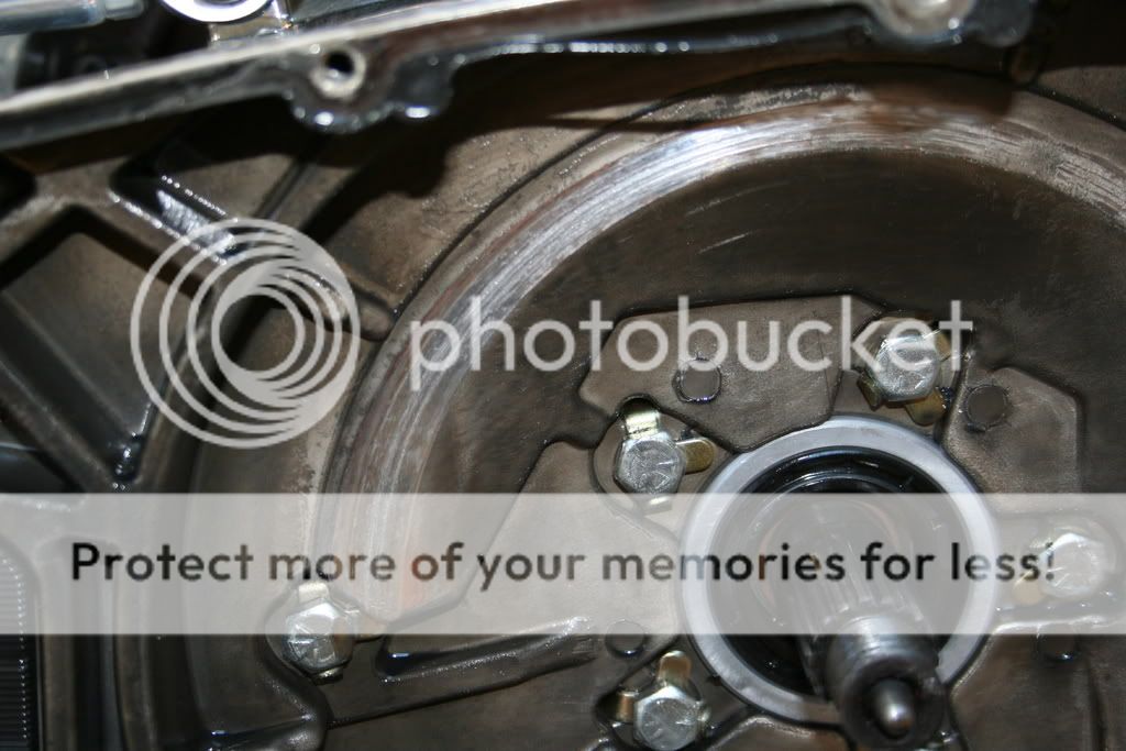

Inner rubed,
No damage here, was allready fixed.

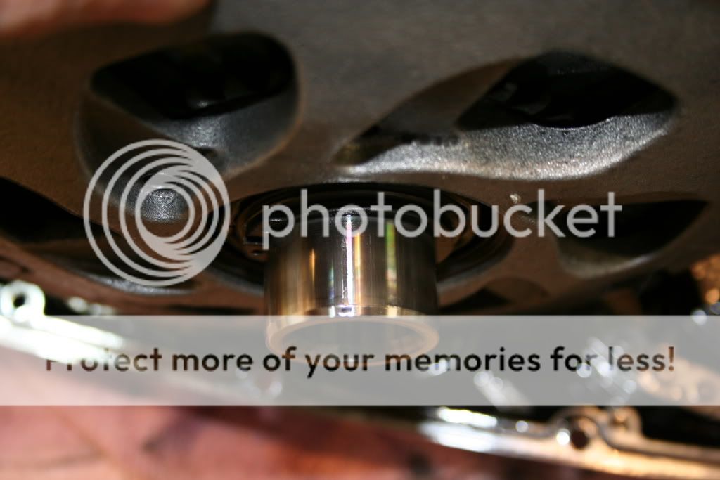

Gashed up Flanged Hub, from before.

What happened there is that the grooves were put in the inner primary when the clutch carrier broke. Then when they pressed the new carrier on the hub , that is where those small grooves came from. When they pressed my old bearing off the hub they ruined it and I had to buy a new one ($50). The bearing probably went in the trans from all the shitty primary fluid that got past the seal and took the bearing.
