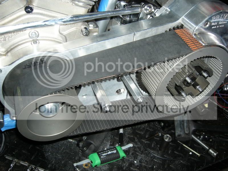

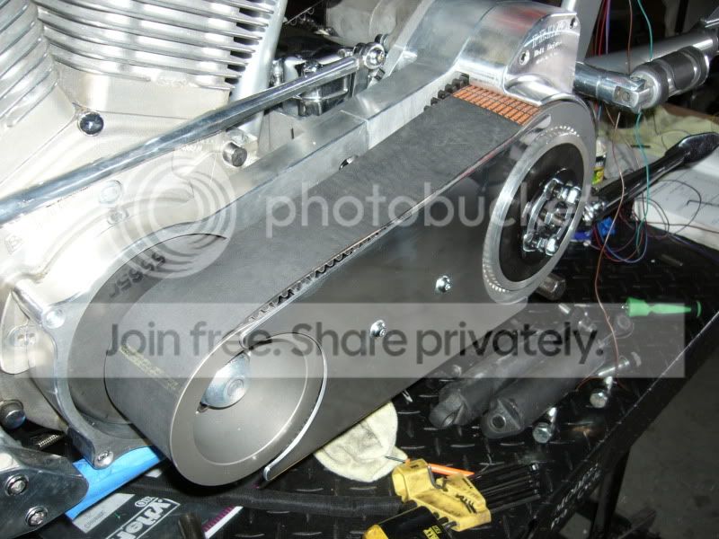

I've been running the Primo for more than a year -- happy with the performance, sounds, adjust-ability and not needing to change fluid :up:
The two-piece back-plate makes installation and adjustment stupid simple.

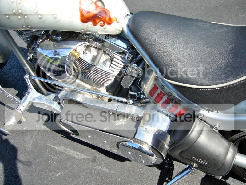

Some shots and a vid so you can hear it whine....
[ame="http://s77.photobucket.com/albums/j61/wcsorcha/Open%20Belt/?action=view&current=P1030025.flv"]
[/ame]
