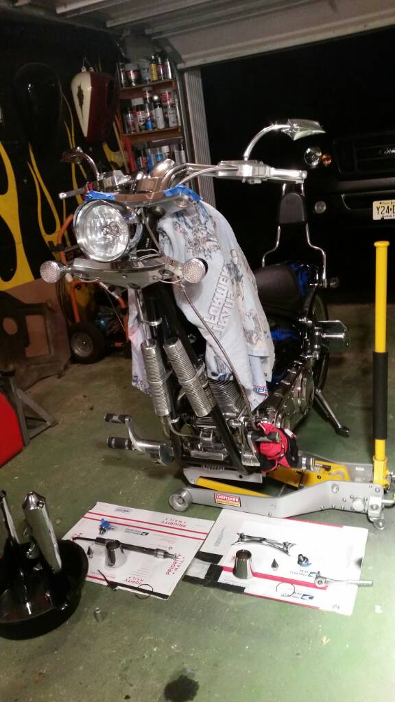

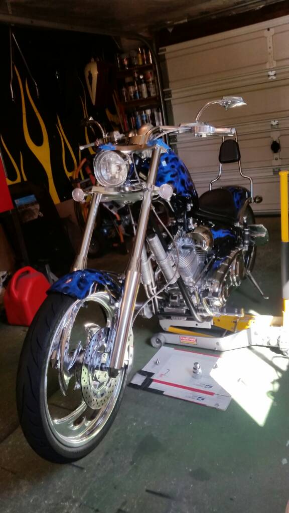

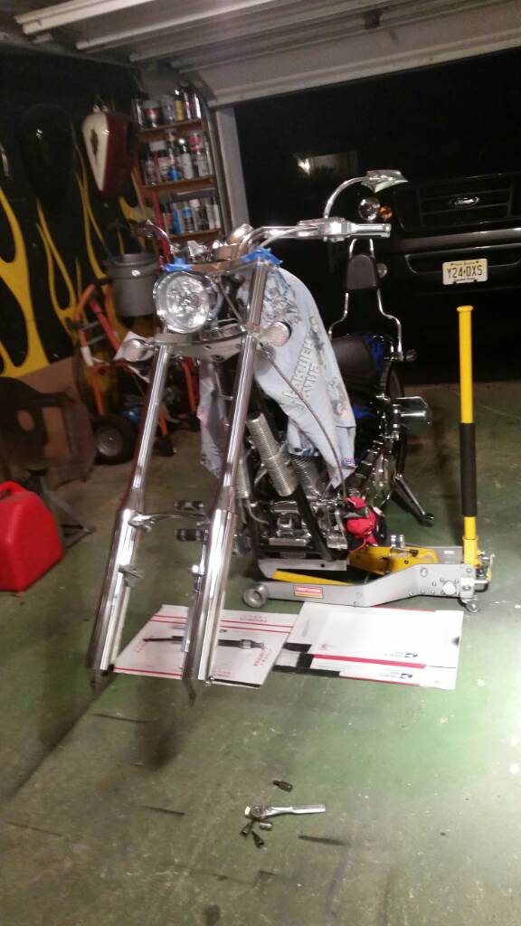

Well I've been putting it off for a while and finally got around to ordering my fork tubes and decided to tackle it This weekend. Ended up buying fork tube assemblies(thanks Kaptain)cause I had a big nick where it rides the seals, and I already had a rebuild kit. Everything went smooth taking it apart, found it easy to separate the lowers while still on the bike, one man operation. After cleaning all the nasty gunk out of the lowers, rebuilding was a breeze too using the seal tool Th3Infamous (Eric) recomended. Then put everything back on the bike, put the front wheel back on started tightening the pinch bolts and before I even had them tight enough to break out the torque wrench, SNAP, the one pinch bolt snapped off. Looking at the bolt, it looks like was cracked for a while and decided to go.
So what started as a easier than anticipated job became a major pain in the ass. It proved not an easy operation drilling out a stainless bolt in almuminum. I tryed an easy out to no avail, then the small drill bit wondered and started biting alumimum. In the end I had no choice but to drill it out larger and put an oversized 5/16" bolt in which I had to grind down the head to fit into the recess. In the end all is back together , but what a nightmare. I'm gonna keep an eye out for a used right side lower and eventually swap it out just so it's right, but for now she's good to go.
Just wanted to say a big thanks to GasMan for his excellent how to and Th3InfamousI for the write on the tool, made life a breeze as far as installing the seal. Never tackled a fork rebuild before only swapped out triple trees, and if it wasn't for that damn bolt it would have been smooth sailing. Just have to have some good weather to test her out.
