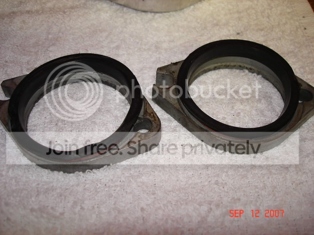

Now there is something weird with the manifold, it looks a bit bent (look at the pictures) what do you think?
Do I need a new one?
Also, do i put the black seals back or do I try the new blue ones made of silicone?

The admission manifold screws were also damaged by wrong tools, that also means that they were at least removed once... Which could explain why the manifold is a bit bent, btw I still would like your opinion on that (pictures in my previous post), do I need a new manifold?

Now that you mention it I've seen that flat spot on my manifolds also. It may be normal. Shoot S&S a pm, they are responsive and will answer your question quickly.

They said the flat spot is fairly normal, and easily cured with a wooden dowel.
Out of interest, they also said that you should'nt use HD seals, as they are too thick and will dent the manifold...
